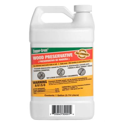

  I'd get a sprayer and spray on Jasco wood preservative. Or one of those cheapo pump up week killer spray bottles. Nice little wand, go under there and spray it all. It will turn it green. No bugs will bother it.  Or any brand of wood preservative. Home Depot sells "Copper Green" too
