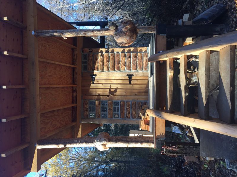

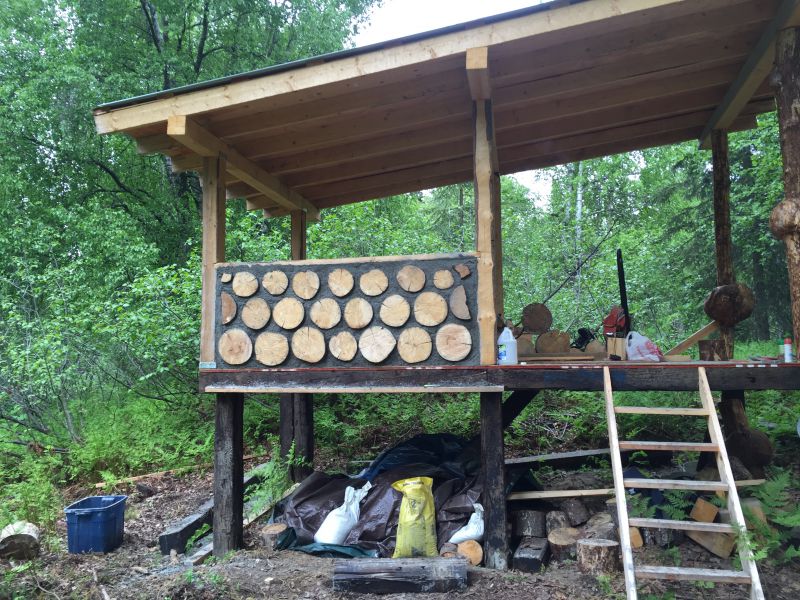

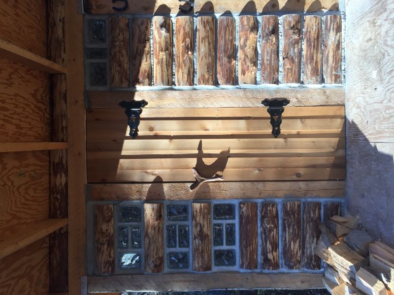

They are a cool way of building, I was interested in making a cordwood sauna. Here is my progress thus far. It will be a 8x8 sauna with an 8x8 porch for changing and cooling. I will tell you that the amount of work put in is a lot!!! Getting the dry wood, prepping it, mixing mortar, laying wood, etc.
We did a solid mortar with no sawdust insulation since it just a sauna and won't really need to retain heat.

None of the buildings I have seen in EU, nor any of the buildings the friends in MI have built are on piers though. That seems like a truly bad idea to me. The walls are heavy, lots of wood plus the fill in cement mix. The slightest foundation movement will cause cracking. If you have ever seen what can happen to concrete block walls when the footing is insufficient you will get the idea. While a stick frame building on piers will at worst, have a door or window stick when the building piers shift a little, a cordwood building will not be so forgiving. Something will give and that will be a separation along the wood / cement line. Not to mention more weight = more trouble in trying to reset things. Cordwood needs a good foundation that spreads the weight over a larger area. Just as with a more conventional wall the foundation needs to go to the frost line to prevent frost heaving.

@AKfisher. Nice burled post(s)!ðŸ‘
