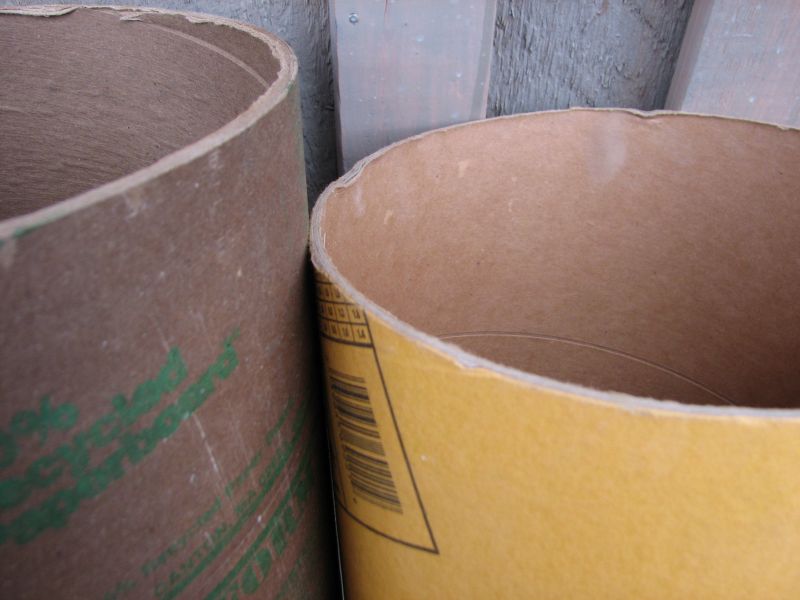

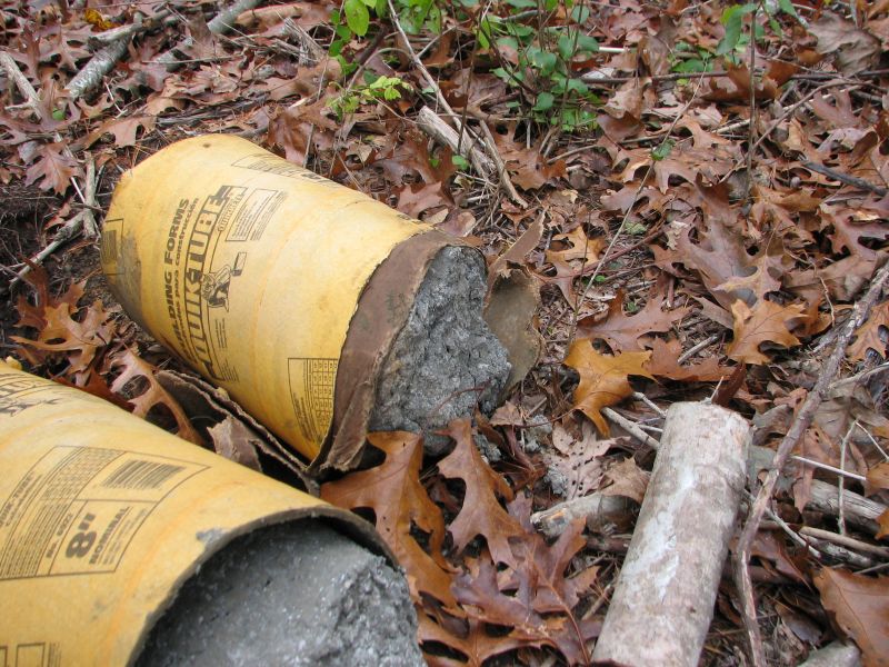

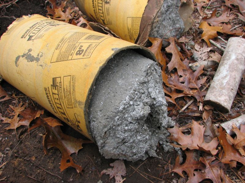

The latest problem is with Lowe's sonatubes. My son and I bought the tubes from Lowes and used them a few weeks ago to start a new cabin. We poured the concrete and set the bolt in one but the next day it had burst and flopped over. The next day we used really dry thick concrete but the same thing happened. These lousy tubes were made out of thin non-water proof materials (compare them to the local good tube in the attached picture). Not only did I waste a weekend but I had get the damn tubes out of the ground; I am thinking if dumping them in the Lowes' lot.
In disgust I went to the local builder's supply place (owned by locals and run by locals). (I should have gone to them in the first place) Their tubes worked beautifully even for wet concrete.
I have attached pictured of the crap tube from Lowes and the thicker waterproof tubes from the local building supply store.
I have also attached pictures of a flopped over tube from Lowes. Never again will I spend a dime with those guys. This is the final straw.

What mix did you use for the concrete?(A mix that has less gravel will have more slump or be more "runny") Did you pour in the concrete or shovel it in?(Pour concrete fast into a form can over stress the form and weaken it) How tall were the forms? How much of that height was out of the ground and how was it suported?(The higher you go with those cheap tubes the more you need support on the outside of the forms) Was there any rebar in the tubes?(Rebar on the inside will help support the concrete and let it "slump" less)
I have used those same tubes in a 2' diameter by 6' tall and never had a blow out with them. I have also had to pour fairly wet concrete in them so it would flow in around the steel easier. But I did re-inforce them with a few 2x4's and tie wire. The weight of the concrete and the outward pressure is greater at the bottom of the form and where they would be most likely to blowout. A collapse like you appear to have had makes me wonder if they were suported any at all. Did you have ANY supports on the outside of the tubes? Any 2x4's going from the tube to the ground at an angle? It appears from your pics that the tubes "folded" not blew out. I would even guess it happened atleast a foot out of the ground? That suggests a lack of support. Go tall enough with steel tubes and even they may topple in the middle. On sonatubes I will use 4 2x4's around the top and angled outwards from the bottom to both hold in place and support the tube. And if it is very tall I will also put atleast 3 2x4's wired to the sides for extra strenght. I do this wether using Lowes brand or the high dollar Sonatube brand tubes. Did you have anything like that?

You can see in the first photo the quality different between the two tubes. The good tub is thicker and waterproof (and even an inch taller!).
