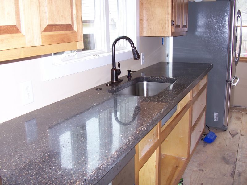

Heres a pic of polished concrete I made has abalone and black glass added cheap to make durable and a 3 feet long piece you could polish by hand with diamond pads the colors and add ons are endless i just wax ours here and there for maintenance

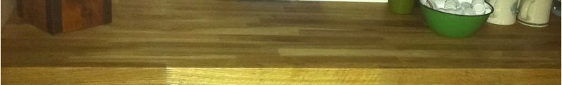

Here is a close up of my wood IKEA countertop,year three in a unheated cabin.
I am very happy with it.
Every summer I heat a little Howard Butcher Block Conditioner(from HD)and rub it into the wood. I let it sit overnight than wipe up the residue and buff with a microfiber towel.
Every year it looks nicer.
P.S-I think the countertop was $65 at the time. I got it for free with money I made taking Online surveys.

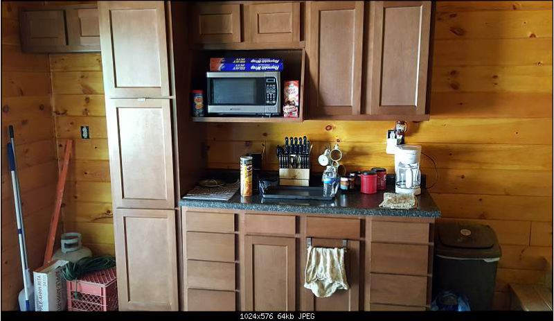

Oh I dunno about "cheap Formica countertops"
Here is my $45 closeout Menards countertop. I think it looks smashing. Cheap, good looking, sanitary, and easy. What's not to like?

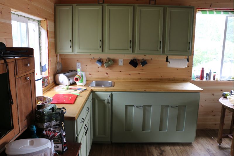

Bit late into the thread but ... I'm like silverwaterlady - no cutting or hot pots on the counter top. Add to the fact that our cabin is weekend recreational only and most of the cooking is done in the "outside"/deck kitchen, I went the really cheap route. Bought some 2x12 pieces, had the guy at HD rip all the edges except one then, using dowels, pocket screws and glue made a counter top. Sanding and a light coat of stain and many coats of poly, add a wood back splash and done (well, maybe a bit harder than that). Two summers and two winters (unheated) with no warping.
