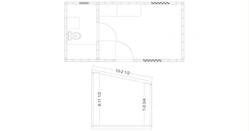

  Ok need some ideas for my 200 sq. ft. hunting shack.  Now I'm not off grid but don't have unlimited power.  I have a power pole about 100 ft. from the shack and plan on getting a small load center, probably 60amp to cover the shack.  I don't want a window unit due to security issues and bugs/mice getting in through the holes.  Thought about a wall mount like you would have in a motel but trying to find a good place to put it poses a challenge.  Thought maybe a mini split ductless but not sure I'm ready to drop $1000 on one.  Maybe a large portable unit??  In the summers I need the cooling when it's 100+, now in the winters well we will get frost now and then but then its 50 to 60 usually during the day.
