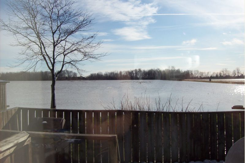

Julie2Oregon As the pic shows , we live in a flood plane , taken a few years ago . Our septic is just on the other side of the board fence , our county regulator told us to add 400 yards of sand to the area before installing the septic . it has never given any trouble even in this flood , I believe they call it a raised bed system .
