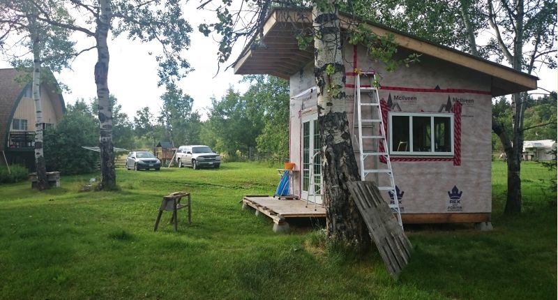

Some embarrassingly unprofessional photos from a crappy cell phone camera. My shed in relation to my house

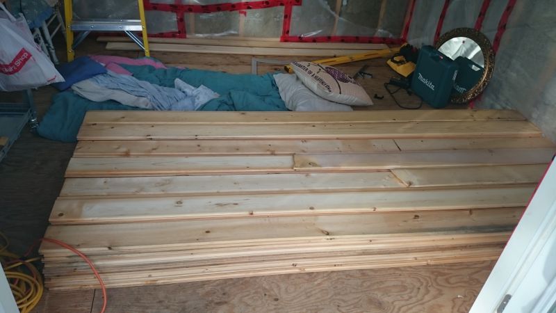

|  The T&G pine lying on the floor of shed

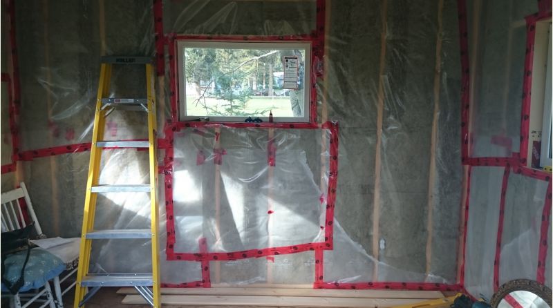

|  Back wall on which we will start installing the pine

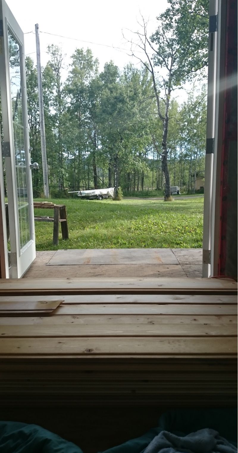

|  View from the back wall, over the pine, out the doors

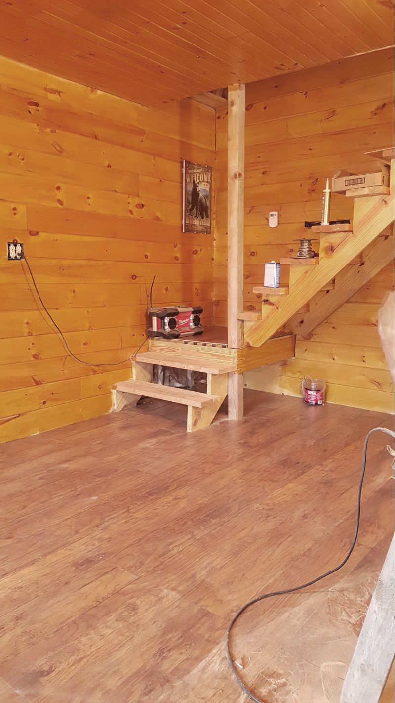

I used good old fashioned amber Shellac on my pine T&G. I love the warm, golden glow, and it was extremely easy to apply. Just make sure you are well ventilated, as the solvent in shellac is alcohol, and you can get a nice buzz going off the vapors.
Polyurethane or varnish would offer better protection than shellac, but shellac does protect and seal the wood.

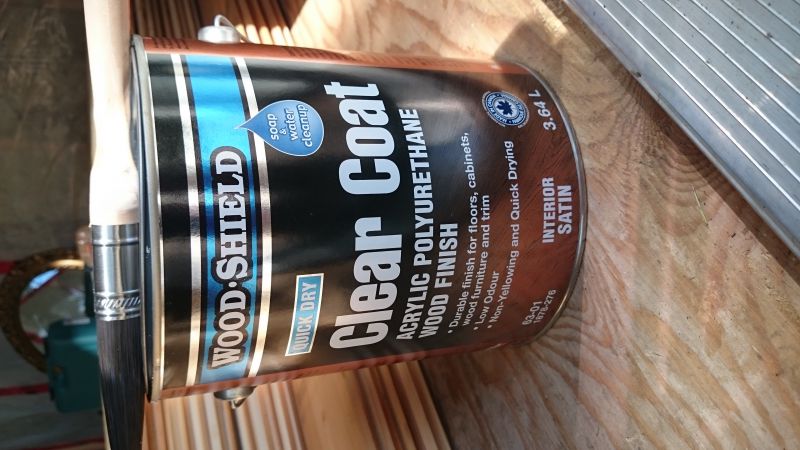

I bought this stuff:
