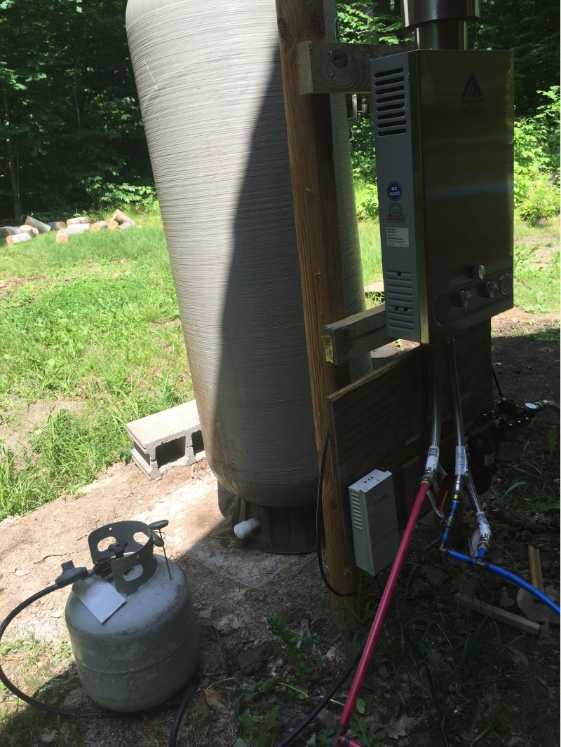

I've got exactly what you are proposing and it works excellent. I did get a 12 volt DC power supply that runs off of 110 volt from Ebay. it gives you a lot more choices on pumps. I'm in a Nordic climate so I made all the stuff on removable panels for winter storage.
My main problem has been mice find the demand water heater attractive as a nesting ground. I check it regularly but if I missed something it would go up in flames as they load it with nesting materials. that's why I choose to move it away from the cabin wall. I power up a indoor toilet, sink, shower and a outside shower with this arrangement. Works great. Even the dogs have been known to use the outside shower.

I would caution you about mounting this directly on wood. In normal operation I would say no problem but I've now had one unit go up in flame and a second one that would have if I hadn't inspected it. The interior of these units are there coils of tubes that a jet of flame goes past.
My mice seem to love the idea of building a nest in these coils. They have built extensive nests inside of a week. When the unit was told to fire it ignited these nest and the whole unit went into flames. My water heater was visible from my outside shower so this got me pretty excited. Pretty good fire dance while nude. It would have been bad news if it was mounted on my cabin wall. Even if there was a panel of steel the steel could heat to ignition temperature of the wood under it. If I were mounting it to the outside cabin wall I would space it off the wall with steel studs.
My witnessing the flaming unit is why I didn't attach mine to the cabin.
