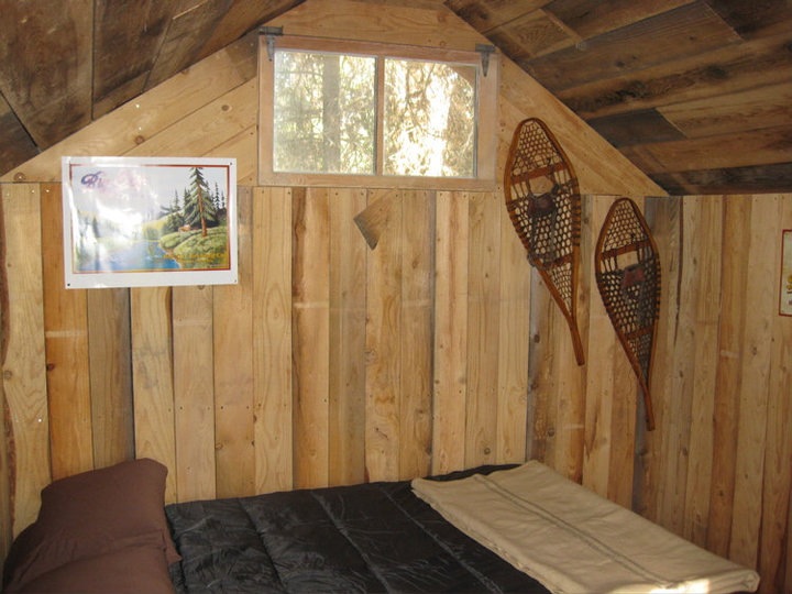

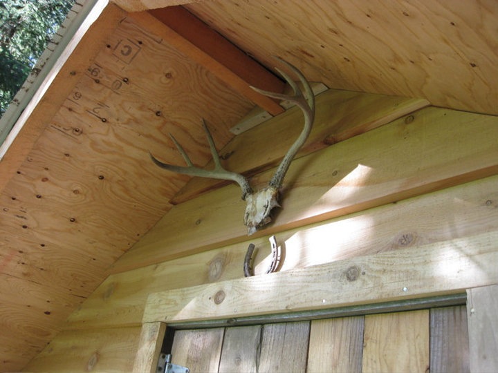

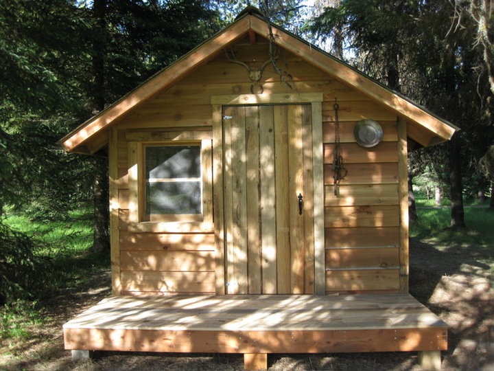

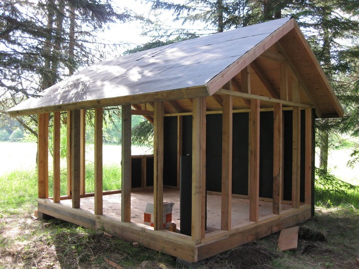

  I don't plan to sheath the exterior walls.  Just house wrap and siding over that.  I did that on a smaller 12x10 cabin and it worked pretty good.  That cabin was built with rough cut and is off grid as well with a blue flame heater and homemade door.  It gets pretty warm but is drafty.  See attached picture of that cabin.  I didn't build it btw.  I had local guy build it while I was out of town working.
