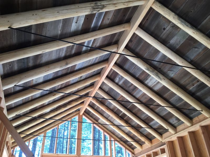

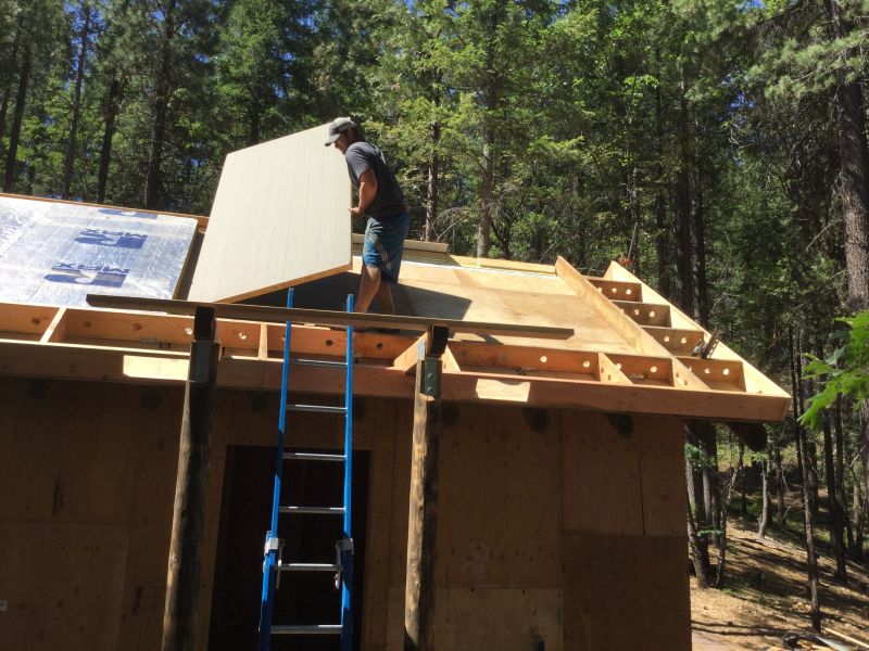

  The main purpose for T+G is just to prevent visible gaps. If you are going for a rustic look perhaps you don't care. I did exactly what you have described, put 1x8 weathered fence boards on the rafters, black felt on that, 3/8 plywood on that, 4-1/2" rigid foam on that, sleepers on the foam for an air space above the insulation, plywood deck on the sleepers- see pics below.
  One problem with this is that the gaps in the ceiling boards make basically a sieve for hot air to go through. So around the edges we put bituthane to seal it off. In winter when it's heated the air will be pushing hard to get out, and you could lose a lot of heat.  Redwood fence boards for ceiling
  |   Rigid insulation up top
