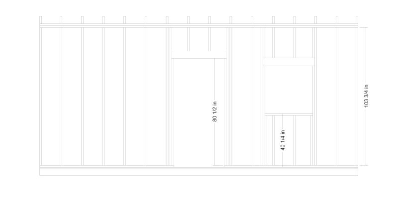

  This drawing may help you.  The measurements are for the shack I am building so adjust as needed for your build
Wilbour
