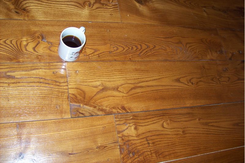

# Posted: 24 Aug 2016 01:32pm
These are square edged white ash boards that were drilled, screwed , and plugged . Random widths 12 ' 10 ' 8 ' and 6 .
make sure your wood is very dry before you start.. they still cupped a bit after installed but the sander took care of that .
I found it worked best with short boards 4 ft. or less . Its very hard to get the edges strait on longer boards and you cant bend a 12 in. board . We get lots of favorable comments about this floor .
poly finish
poly finish

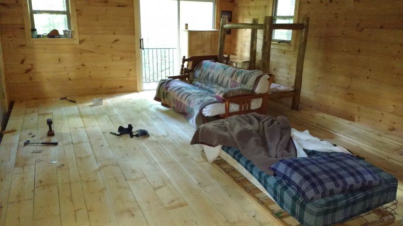

I took the gamble on 1x6 pine boards this past weekend. Installed them as tight as I could. I used trim head screws every 16 inches through the sub floor and into the floor joists. Going to stain and poly next time I am there to try and lock out some of the moisture.
pine boards
pine boards

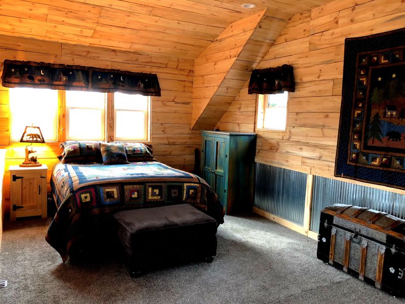

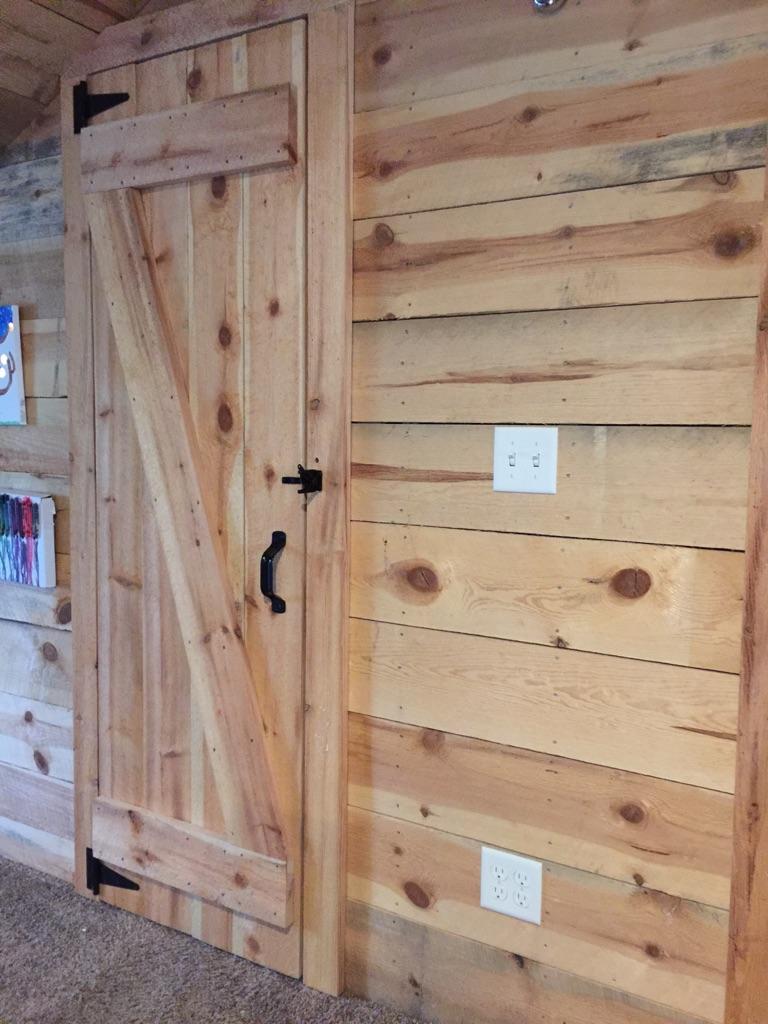

# Posted: 9 Sep 2016 01:07pm
My In laws used 10 inch rough cut on their walls and ceilings and we liked it so much we are going to do the same.
Pine walls
Pine walls

carr0406 and Norsky, those pictures look great. I have some extra rough cut that I'm going to do partial wall on the loft with now (bring the corners in with the Pine Board and Batten style, and connect the corners with a railing so the kids can look down into the main room - ladder will be a pass through at the gable end). Next is a shot of the floors. I really like how they look, now we debate finish now or finish later... Has any tried that new (to me anyways) Penofin Verde?

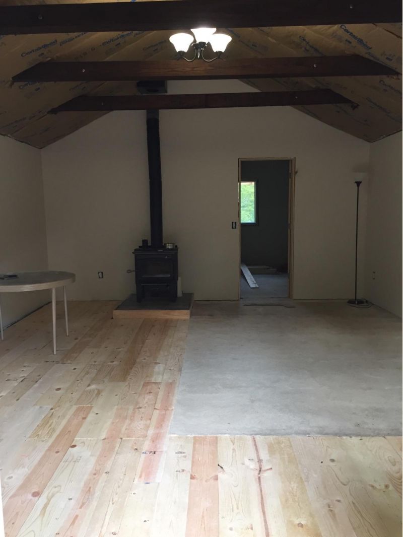

CootersShabin
# Posted: 16 Sep 2016 12:49pm
Floor:

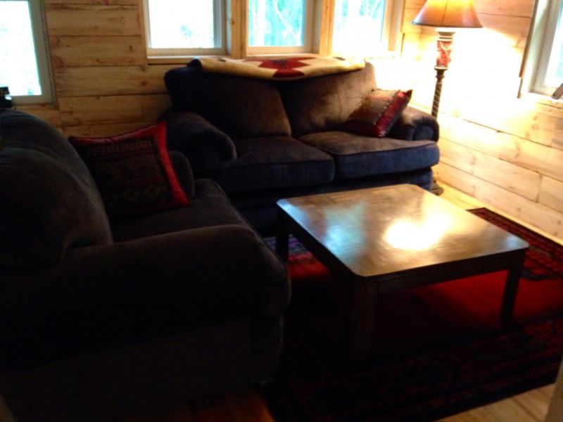

Norsky
# Posted: 31 Mar 2021 08:11am
I would do it again. It's definitely rustic but we don't mind the flaws.
living room
living room

# Posted: 7 Apr 2021 11:13am - Edited by: CootersShabin
Others have already replied, and indeed it is tough to sweep real clean requiring more vacuuming. No splinters yet walking barefoot though, so definitely a pass. It's taking on character pretty quick too! All in all it goes well with the rustic charm though. I've since added a steel border between the wood and tile.
