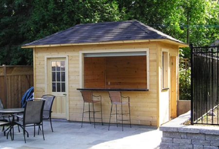

You say a cook house. Are you cooking with a wood fired stove? Where will the chimney come out through the roof?
I always find that 2x6 rafters are under-sized, snow or no snow load. You'll still have to walk around up there sometimes and a 2x6 is really only 5 1/2" of wood. Definitely don't go to 24" on center.
You might consider designing it like a pool cabana, with a large door on the long side and then have flip up windows above an eating counter (seating inside and outside).
A shed roof is definitely easier to frame (no ridge beam) but if the slope goes below 3:12 you should switch to a metal standing seam roof.
