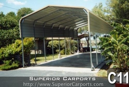

I have a carport that I am thinking of converting to a cabin. Building a wood foundation on piers, setting carport up on it, securing it. Build 2x4 frames allowing for windows between the uprites then enclose the outside with siding, insulate and panel the inside.
here is a pic of one similar to the 1 I have. Mine is 5' tall at the corners

I would scrap that idea and do it right... You are not saving any money or making anything easier..... just my opinion....
# Posted: 7 Dec 2010 11:17pm - Edited by: MtnDon
My off the top of my head first thought is it would not be worth the effort to work around the steel framework and roof restrictions. . The basic shell of a small cabin, from foundation up through the roof is the quickest part of the build , in my opinion. I am always amazed at how fast I can make that happen. Then I'm also sort of amazed at how long it takes me to complete the interior.
Take the roof. A metal roof will have water condensing on the underside once it is closed in and warmer inside than the outside air. I would not trust only insulation and a vapor barrier under the insulation to keep the underside of the skin dry. The only real way to get around that with a metal skin on a steel frame like that would be spray foam on the underside. Okay, there are ways by stretching tar paper or building wrap under the metal and placing insulation under it. Is it worth the effort? I say no, but OMMV. (Others Mileage may vary).
With five feet at the corners I'd think you would have to build a short wall anyhow.

+1 on the idea that you won't be saving money by using wood to close in the carport.
You worded your original post to imply that you already own the carport. If so, then I think your only realistic path to close the carport would be to go back to Superior Carports and ask them what additional steel components you need to buy from them to close in the carport and make it into an all metal building. Since a big chunk of Superior's business is in utility buildings, not just carports, they should be able to help you. The price to close in the building with steel components that are purpose built for this will probably cost more than an all wood cabin, but perhaps you can get close. So, if you must use your carport, I think that's your only path to a waterproof and windproof structure.
In the end, I think you'd be better off selling the carport and use that money towards building an all wood cabin.

For a couple of years, I worked for a company that sold these units as an add on to the primary business of manufacturing and selling metal roof panels. Designed and sold many during that time for sheds, workshops, boat houses, RV ports, carports. Did a few as a quick build shelter in Haiti. If yours is as I expect the tubes are 60"on center and the roof panels are 29ga running horizontally. In the middle this will carry almost no loading at all and does not meet the recommended screw pattern for the panels....not even close. If you do not expect snow that may sound like a non issue, but I have seen them collapse from ice and fold up like an accordion from wind gusts during a severe thunderstorms. Also have several penetrated by large hail stones.
If I were you, I would just buy and have delivered a wood framed shed and go from there. The extra cost is cheap insurance and time savings alone will most likely cover most of it.
But if not, at least have them add 16ga hat channels minimum 24" on center and run the panels vertically as they were intended to be used. That will at least give you some lateral support, better water runoff and much better support for the panels.
