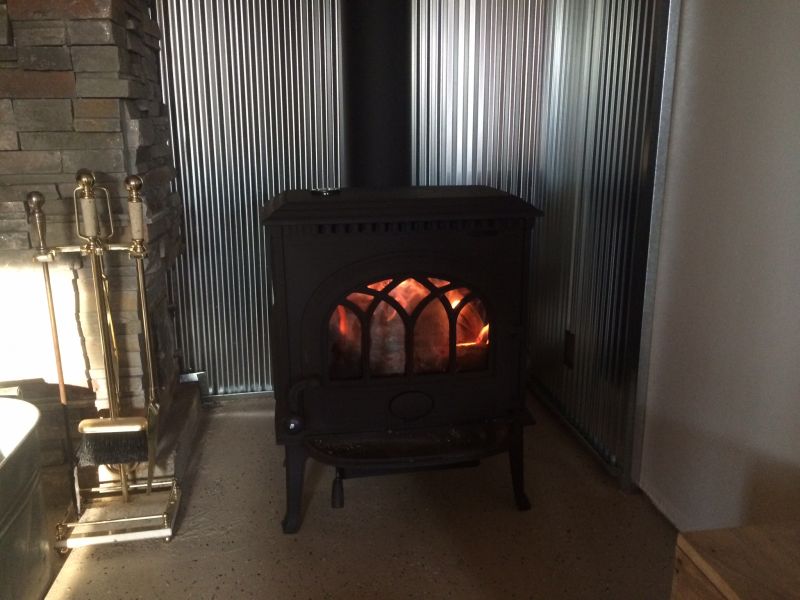

# Posted: 9 Sep 2016 12:15pm
Is that a Jotul F 3 CB? How do you like it?
itsals1
# Posted: 10 Sep 2016 06:10pm
Bret
We love our Jotul F 3 CB!
We have a Oslo at our home and this is basically a smaller version of it, but has a few differant features. The F 3 CB is front load only and does not have fire brick, but it does have a ash pan which my wife demanded. It also has a double draft, the standard one and one built into the door for easier starts. One thing to keep in mind they say 18" wood ! but 14"-16" small splits work the best.
So you need to cut/split your wood smaller. Our cabin is 480sq feet and it is a wonderful addition compared to the old smoke dragon that the previous owner had. They are not cheap to buy, but a good envestment for long therm. Morso is a excellent stove as well. I really wanted one myself, but my wife did not care for them as much as I did. In the end our Jotuls are excellent stoves. I would like to upgrade our Oslo with a soapstone heater though, time will tell.
