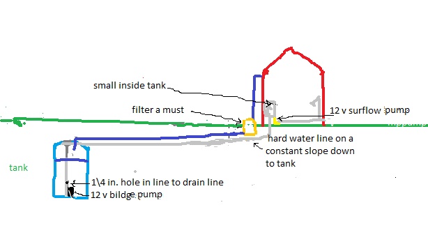

# Posted: 3 Oct 2016 08:01pm
frost protected 12 v system
frost garded
frost garded
