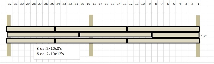

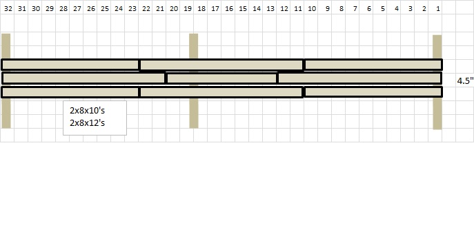

I'm thinking about making my own ridge beam onsite for a 20x32 cabin out of 2x8x10's and 2x8x12's using construction adhesive and bolts. Rafters would be 2x6x12's 16 inch on center. Looking for opinions.
EDIT: Thanks Don. I forgot to describe the support wall shown at 18 ft. How about Gorilla (expansion/hydraulic) glue?
# Posted: 11 Oct 2016 02:30pm - Edited by: MtnDon
Reply Quote
If you had supports columns centered under the splices it would work (everything sized properly of course). Construction adhesive has some creep when the glued together parts have shear forces involved. The typical construction adhesive also slowly degrades over time, although that may be measured in decades when everything is kept dry. Epoxy is too hard and does not adhere well enough to wood. Glues like Titebond also creep under load. Two part resorcinol glue might work but I don't know about how strong it is is the material does not fit tightly together. I don't know the gap filling properties, in other words.
The strength of through bolts is dependent upon the strength and integrity of the area above and below the bolt hole.
I don't believe there is a good method for making a DIY laminated beam for a clear span of 32 feet. Factory manufactured beams use special adhesives, heat and pressure.

Does the mid support wall sit on a raised floor, if so, is there a pier under it? Roof load should always go directly to dirt.
Overlapping the 2xs only two feet is not enough, and I agree don't rely on glue. Construct or buy a 14 and an 18, land them both on a 4x4, put a concrete pier beneath the 4x4 if there is not one already. Or, put a beam beneath the 4x4 spanning between two piers. If it's on a slab you may need to cut a hole for a pier.
If there is no pier below the 4x4, and you don't want to put one in, you are effectively spanning the whole 32 feet anyway. You could manufacture a site-built truss for that, but you can't design it yourself. Might be worth having it engineered just because it would be easy to make on site and easy to transport the needed materials to the site, if that's an issue. A cooperative truss manufacturing company may be willing to design it for you cheaply with their software.

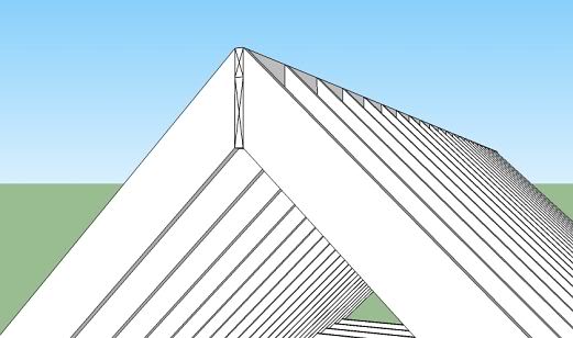

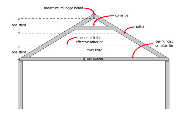

A couple things.... First, the drawing is mislabeled. The component the drawing labels as a collar tie is actually a rafter tie. That drawing has no collar ties shown and they are required by code. An alternative though, is to use metal straps nailed over the peak, on the same rafter pair collars would be used. nail them on over the sheathing is fine.
The drawing I have posted is more correct as to how to determine thee 1/3 distance. That drawing also indicates the correct, allowable placement for the collar ties. Many folks confuse rafter ties and collar ties. The original posted drawing is not the first incorrect one I have seen on the infallible internet.
A collar tie is placed near the top of the rafter triangle to help keep the peak together under high wind conditions. The lower rafter tie is there to prevent wall spread.
One more thing... if the rafters are raised from the lowest, ceiling joist position a correction factor may have to be applied to the rafter size selected. As the rafter tie is elevated new and unplanned for forces are applied to the rafter. This will mean that much of an lift will require a larger section rafter. See the IRC here... The details are in the footnotes.... READ THE FOOTNOTES when using IRC tables as they are there for good reasons. [scroll down to table R802.5.1(1)]
A ridge BOARD is nothing special. It is not structural. You could build a rafter roof without any board at all. It's main purpose is to make the roof easier to assemble. It holds the rafter peaks in the proper places, spaced correctly. So it could be several pieces.Splices don't have to be anything fancy. Positioning ridge board splice between rafters and scabbing with a piece of plywood on each side works and is simple to do. No fancy cuts required. Of course that is assuming the ridge board will be hidden from plain site, which is the usual way. The board should be as wide as the surface of the slant cut that makes the rafter point. It could be two boards one above the other. We want to be sure the entire slant cut at the peak is fully supported to help prevent loads from causes splits to form.
A ridge BEAM is a totally different item. It is structural and requires proper engineered design.
Rafter specs come from readily available tables in the building codes as well as other sources. There are online calculators that are simple enough to use. You need to know the species and grade of lumber to be used as well as the ground snow load for the project site.
The second image (one of Don_P's) illustrates a stacked ridge board to provide full cut face support. The ridge board could extend below the rafter edge . collar ties vs rafter ties
|  one of Don_P's images

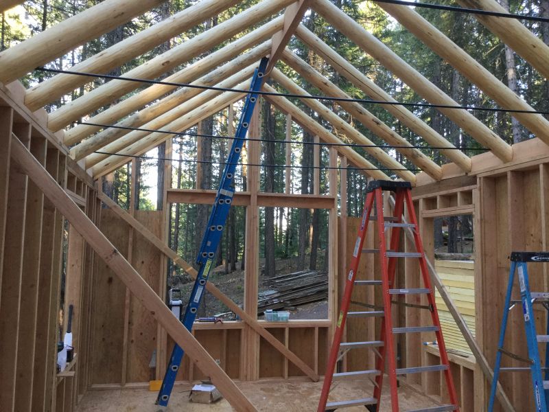

I've come across a couple photos where three beams were used. A ridge beam plus parallel beams bisecting either side. Any thoughts on that?
Something like this but of sawn / dimensional lumber:
 http://www.explodedhome.com/wp-content/uploads/2014/09/Ridge-beam-in-Cabin-ceiling.jp g
Also, do renovators putting beams under an existing ridge board ever mix wood dimensions to maximize the depth given the rise on the rafter. Eg. 2x14 in the centre with 2x12s on either side (down slope).
Also I saw a photo on the Internet of an old European building where the bottom of the beam wasn't just three boards evenly laid side by side but offset slightly and the edges had a routered look (but it likely predated routers by a hundred years). Looked really good compared to the simple square/box look.
# Posted: 15 Oct 2016 02:05pm - Edited by: bldginsp
Reply Quote
The beams running mid-span to the rafters are called purlins. Note that the purlins in the photo have no support mid-span, so the engineering for such a roof needs to be carefully worked out beforehand.
Don't understand the second question.

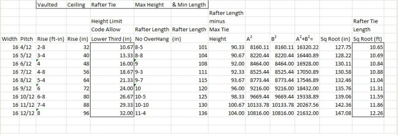

Rafter Tie Length Calculations at Max Rafter Tie Height
# Posted: 17 Oct 2016 10:08pm
Reply Quote
What I found about Collar Ties.
Collar tie or "collar beam" is not generally required by code. They may or may not be required, depending on jurisdiction. (Not required by IRC but may be required locally) Collar ties are probably not needed if metal connectors were used to fasten the rafters to the ridge. (toe-nailed rafters need collar ties, else metal hangers on rafters) It is specified by engineering to assist with maintaining the rafters to the ridge board connection in high wind or imbalanced snow load areas. They do not help with wall spread.
# Posted: 17 Oct 2016 10:18pm - Edited by: DaveBell
Reply Quote
Rafters, using IRC R802.5.1(1) and the Rafter Span Adjustment Factor table in the footnote.
The footnote is required to calculate the rafter choice when a ceiling joist will not be used, such as when a rafter tie is desired to create a vaulted ceiling with a ridge board.
Another choice is a cathedral ceiling by using a ridge beam. Rafter ties could be added at any height since they are just for aesthetics as-is or used to create a vaulted ceiling.
Given a cabin size of 16 x 36, a 16’ Roof Span and 6/12 Pitch, the Rise is approx. 4’.
EDIT: I mixed my explanation work without using my choice for the cabin. All below has been changed to match my choices from the spreadsheet.
The 10’ rafter with 1’ overhang = 9’ Rafter Span.
Wanting to use a tie versus a ceiling joist, what grade and size lumber do I need per table R802.5.1(1) ?
The footnote Rafter Span Adjustment Factor (RSAF) HC/HR is read as 1 foot up/3 foot rise, 1 foot up/4 foot rise and so on to establish the factors.
The HC/HR of 1/3 = 33%, the maximum allowable height. The other HR/HC provided (1/4, 1/5, 1/6 represent lessor heights (25%, 20%, and 17%) respectively.
My height choice for rafter ties is the maximum, 16†in a 48†rise (16/48) which correlates to (HC/HR 1/3). (16/48 = 0.33, HC/HR of 1/3 = 0.33) HC/HR of 1/3 or 0.33 = RSAF of 0.67 from the table footnote.
You can already see that multiplying any rafter span on the table by the RSAF we found will reduce the span.
But you could also use the reciprocal to find the required span for a rafter tie.
(reciprocal of 0.67 is 0.33 or multiply the span by 1.33 to find the new total of the adjusted rafter tie span.
Rafter Span x reciprocal = Adjusted Rafter Span 9 x 1.33 = 11.97 ft
Converting decimal Adjusted Rafter Span to inches, 12 x 0.97 = 11.64 inches or 11’,11.64†12.0’ (rounding up)
So if I want to use a rafter tie 16†on a 4’ rise, I find items on the table equal to or greater than 12ft-0in.
If you look through the tables, you can find any 12’ or greater board 2x8, 2x10, 2x12, 16â€OC, 19.2†OC, 24†OC, etc.
I’m going to use the Table section 30psf Live Load and 10psf Dead Load, 16†O.C to find lumber greater than 12’.
2x6 Doug Fir #1 span is 12-9 2x6 Hem-Fir #1 span is 12-5 2x6 South Pine #2 span is 12-6 2x8 South Pine #3 span is 12-4
These are the closest choices that meet the specification while minimizing cost. There were also three suitable choices under the 24†O.C. section.
