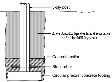

You could try a pole barn technique where the posts go down into the ground below frost level and rise up to support the floor and roof. It's kind of like putting in a fence post and then the sill plate of your raised floor is attached to the sides of the posts.
Typical Foundation detail

DO NOT set wooden posts in concrete unless you are required to by code. They will rot off quickly. auger down 4', drop in a concrete round, set your post then backfill will pea gravel using a rod to settle the gravel every 6". the post wont move and will last a VERY long time. If your worried about frost heaving the post up go deeper. that's my .02 and how we built pole barns and set post up in northern Illinois & southern Wisconsin
