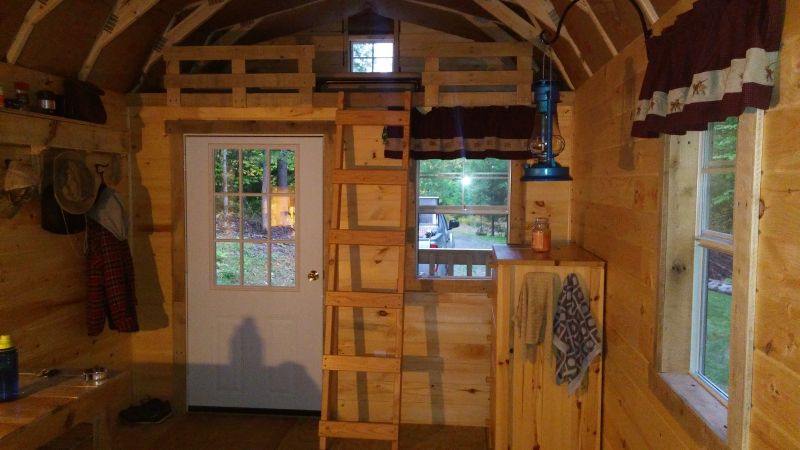

Hello, I'm converting a 10x20 shed (inside is 10x16) lofted shed into a hunting cabin. The walls were easy with rolls of fiberglass insulation. The shed does not have ridge vent or soffit vents and the roof goes like this: metal roofing, tar paper and OSB and 2x4 gambler style rafters. Any modifications, like putting ridge vents of soffit vents are out of the question. I was thinking putting rolls of faced fiberglass R-13 between the rafters and than covering them with plywood and adding two gable vents on each side of the shed/cabin ( I would close them on those winter days when I stay there and leave them open when not there). one would be right above the small window in the loft and the other on the far end.
Is this idea not gonna create problems in the future with mold, condensation in the roof rafters?
This is a hunting cabin and will see occasional use, more stays in the warm months, as for winter only hunting season. It will be heated with electric heater as for right now, maybe a small wood stove in the future. Light cooking, there is no bathroom inside. I'm attaching a few pictures to get a better idea.

can you post a picture of the ceiling including the ridge from the inside

with the way the trusses appear to be built you could insulate off bottom of the 2x4 and then put a ceiling up creating a small attic space that you could then use gable vents with. as long as the insulation isn't touching the roof that would give you air flow in that space.

Thanks for the replies. I did not want to spen a fortune on foam insulation since I already have fiberglass in there. Im gonna go with 2 gable vents and modify the ceiling to create a small attic that should give enough room for ventilation and the fiberglass wont be touching roof. Thanks
