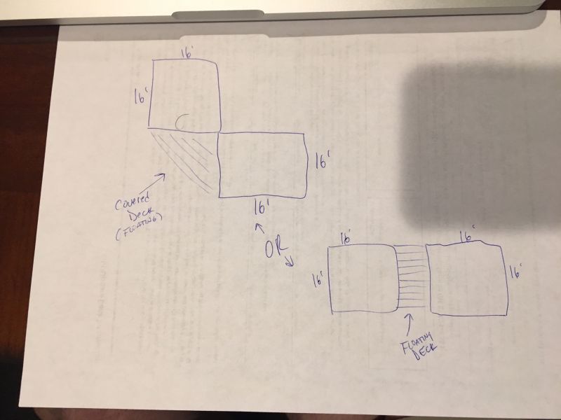

# Posted: 31 Oct 2016 05:55pm
Is it feasible to work around that limitation by "modular-izing" the cabin like what I have in the attached picture? One 16x16 for living / kitchen, and another as a bunk house?
There are 4 of us (Me, my wife, and two daughters). We'd like for it to be comfortable for the 4 of us, as well as if we want to have friends / family over.
I'm open to other suggestions for a foundation...I just assumed the deck blocks would be the easiest, but if there are other ideas, feel free to share.
Thanks!
Salty Craig
# Posted: 31 Oct 2016 06:32pm
cotxwx
If the soil isn't deep to the rock, can you dig to rock and stack up from there with blocks?
I personally don't feel that there's a size limit to what can be on blocks. Don't skimp on piers. There's old building such as train stations, etc. on piers that are huge.
If the rock is bed rock, I don't foresee frost issues.
# Posted: 31 Oct 2016 06:39pm - Edited by: MtnDon
We love CO and have spent much time there spread over 40 years of travel. It is a beautiful place, coveted by many. I believe every county in Colorado enforces building permits and following the building code that the state has adopted.
With the varied terrain and weather in CO there cab also be large variations in what is required per location. The snow load in particular can vary immensely just over a ridge. As for foundations, if the location is covered by the IRC deck blocks are not permitted at all. One main reason is that such blocks offer no uplift resistance. They also do not offer any lateral resistance.
Use Google to search for "building codes permits for XYZ, CO" where XYZ is the name of a county or town. I chose Walden, CO (Jackson county) to use for an example. Here's their posted info That document states that the code applies to unincorporated areas as well. As well there will be zoning rules that may set minimum square footage requirements.
IMO, it is best to start with researching the zoning, permit and code enforcement before spending any money.
