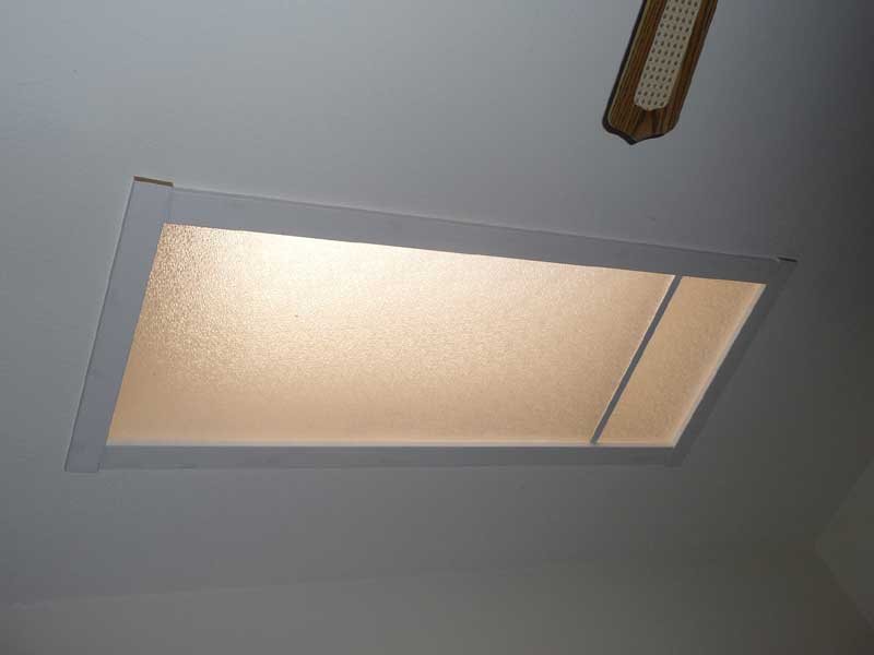

Is there space enough to allow trimming the interior opening with window casing and inserting acrylic panels instead of drywalling? Then install some LED lights in there. Then you don't need new drywall. We have done that on one of our skylights. It uses a light shaft from the 5/12 pitch roof to the 2/12 sloped ceiling, so there was ample space for lighting.

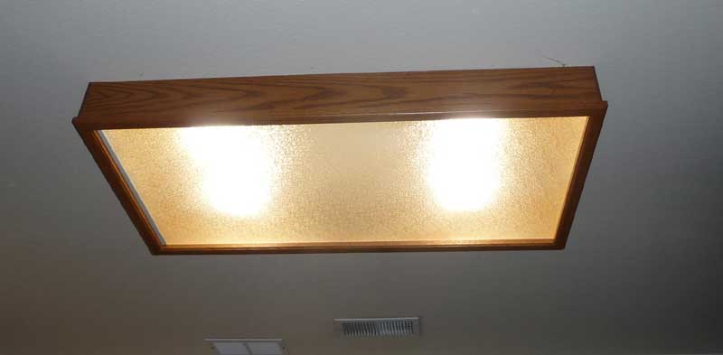

I would but we have not owned that house for a long time. At the time we used FL tubes. I do have a light box I built for the kitchen. It drops down about 5 inches from the ceiling and uses screw in base LED lamps. I also have one skylight shaft with an acrylic panel and trim. No lights in that shaft, just the skylight. I can do a picture or two later.
There are good skylights available.We have two Velux. Google them. But they are heat holes all the same. However in some climates it can be nice to have that can be opened to exhaust air. They also make models that open for roof access; handy on a two story building.
# Posted: 12 Nov 2016 06:49pm - Edited by: MtnDon
The skylight is trimmed with painted plain casing. It is in a The small panel is at the higher end. They were leftovers from other work. The oak light box uses 4 60 watt std LED lamps in sockets I bought at the local hardware store. The box was originally built for F40 FL tubes.

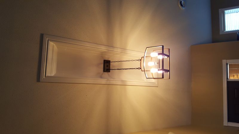

# Posted: 1 Apr 2017 04:05pm
Well I thought I'd update this post and show what I came up with. I know this is not my cabin but the ideas above were helpful. I decided to drywall halfway down the opening and then trim it with crown mold and door casing around the outside. I figured if it was going to look different I may as well make it stand out. We got the light at costco and really enjoy the lighting the retro bulbs give off. My wife is very happy which is all that matters.
