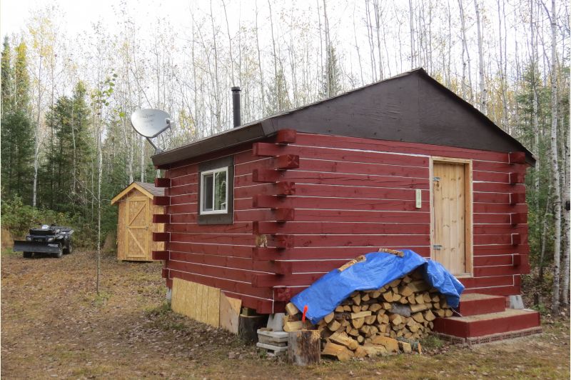

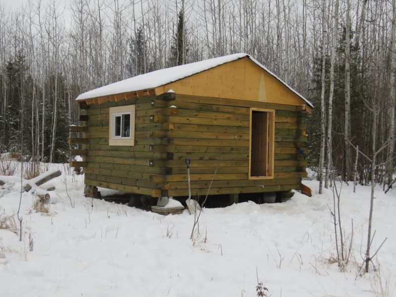

I used them on my cabin, would have preferred untreated. From what I understand, they are safer now. I'm no expert but my opinion on painting them is to let the cabin dry out for a couple of years, otherwise the moisture bleeds thru.........
