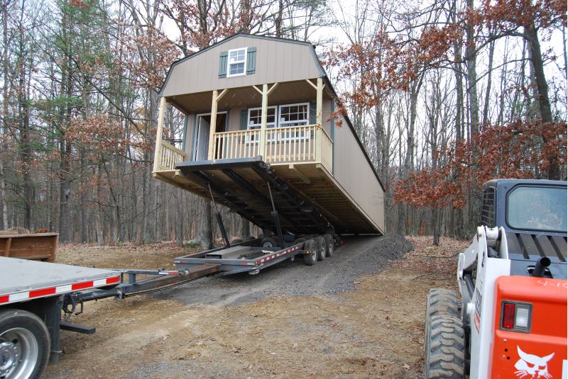

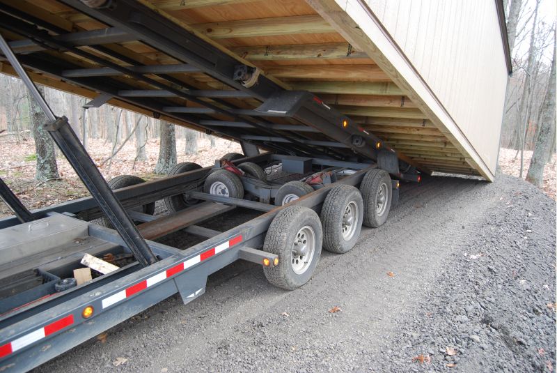

I can't add a lot of technical expertise to this thread, but I can add what may be a helpful picture. Below is a picture of the underside of my cabin. It was moved by the company that built it using, as you can see, a specialty-built trailer. But this cabin is 14' wide, and was moved over 30 miles on roads ranging from two-lane state highways to rough and eroded dirt. I'm not 100% certain, but I think the floor joists (those running perpendicular to the trailer) are only 2x4's. Underside of 14'x40' cabin
|  Cabin offload

Thanks for the info PA_Bound... The skids and floor joists design is interesting in those pictures. Appears to be 4 skids that are 6x6 that run the length of your structure.
Do you know what the cost was to move your cabin or was it included ? Do you know what it would have cost to move it the 30 miles should you need to move it again ?

I think those skids are actually 4"x6"'s.
That 30 mile delivery cost me $500 in 2011. But that included a 2nd person on the delivery (needed to help navigate and halt traffic for certain turns), some tree trimming on the dirt road back to my property, and a premium fee for a "tough delivery" (which it absolutely was). All-in-all I was glad to pay it- given the overall complexity.
To do it again, I would expect it probably closer to $1000 now. But even at that it would still be worth the cost to not have to do it on my own.

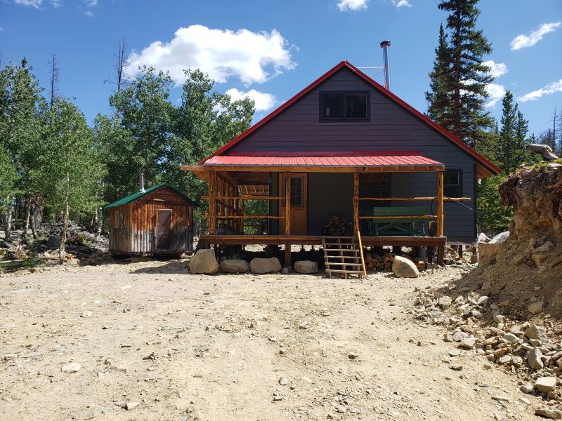

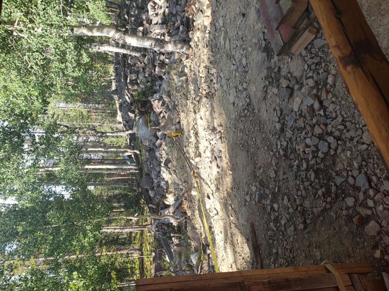

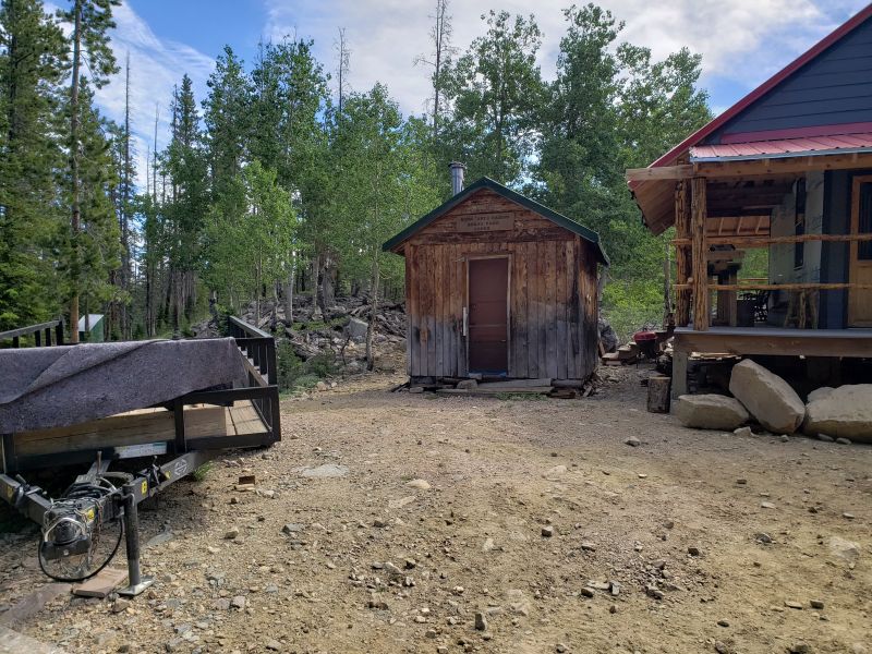

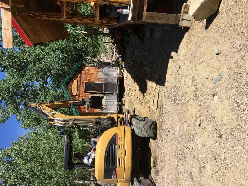

I just moved my grandpa's old cabin this past weekend. I used a 12k mini ex and and a 24k chain winch. It's built on skids, so it was just a matter of getting rollers under it and moved. It was built in the 50s and has survived 70 years of very deep snow each winter, so I assumed its built solidly. We were able to Jack eack corner with a 3 tone floor jack with reaalitive ease. I bet the 12x15 cabin weighed 6k pounds. 20190714_100206.jpg

Nice cabin snobdds. Where you able to use the ex arm to pull the cabin? I have a mico ex 3500lbs. I built a 4.5x6ft out of 2in thick slabs and was only able to skid it this way. I had to dog the blade in and pull with the arm. Worked well though. I built it at home and towed it 3hrs to our property, unloaded it at 10pm in the middle of the road.
