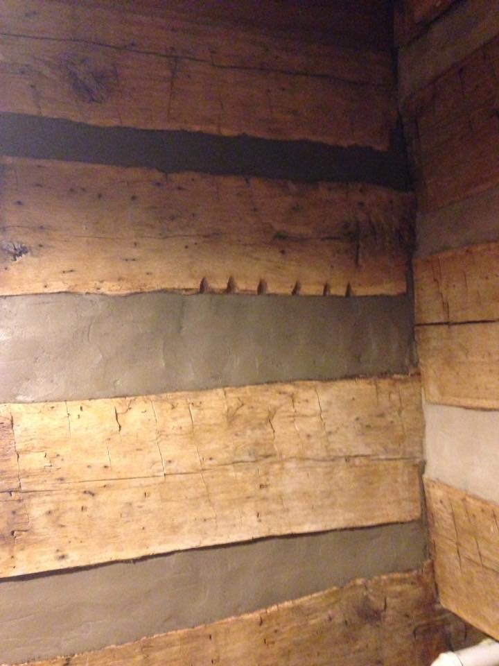

Yeah, Permachink is over the top. Probably a good product but... here is a pick of mine,..just out of the bag mortar.

man that looks great but those are huge spaces to fill arent they?

They ARE! My cabin was moved in 1903 and when the put it back together they shimmed every log raising the ceiling a foot or more. But with the wire mesh, the chink/mortar is 1/2 inch thick at most.
