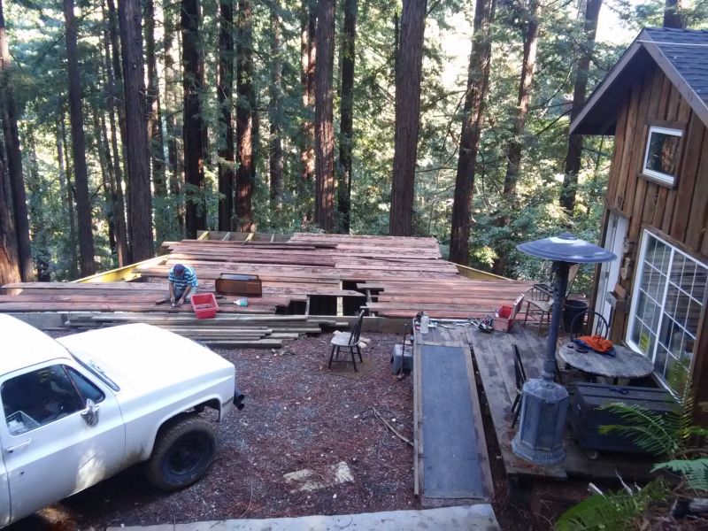

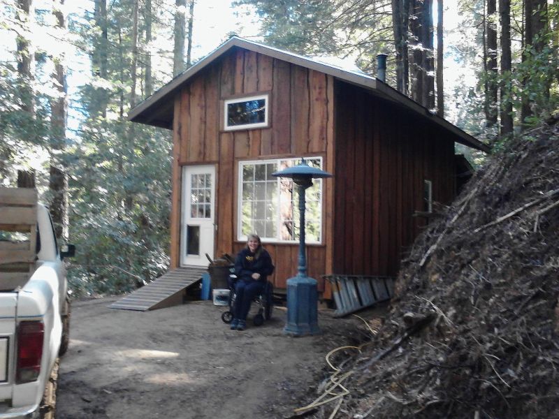

Looking good. Yeah always more work with home milled lumber. I did board and batt siding, or a variation of, for my siding. I left the edges live on both, and thickness variations weren't all that important.

Quoting: paulz Looking good. Yeah always more work with home milled lumber. I did board and batt siding, or a variation of, for my siding. I left the edges live on both, and thickness variations weren't all that important.
Well that is a sweet looking cabin … sawmill?
