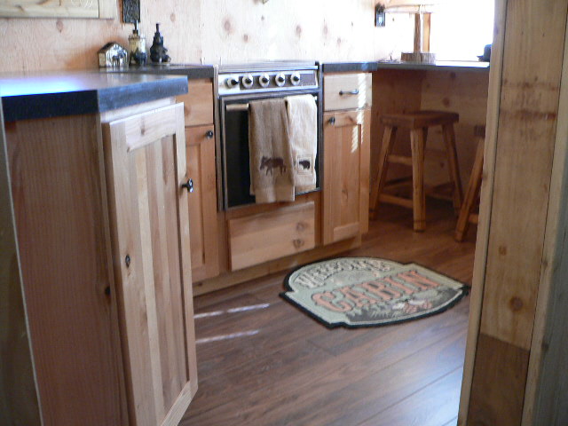

# Posted: 25 Dec 2016 11:12am
I have the laminate wood looking floor in my cabin, unheated winters, this is the snap together stuff that floats on a thin foam pad. Never an issue. I dont think it expands or contracts much, its very dense, in fact, when cutting it, it looked like plastic, not very porous. So its expansion rate is probably very little. It gets real cold over at my cabin, close to the 0 mark, and mid teens for highs right now.

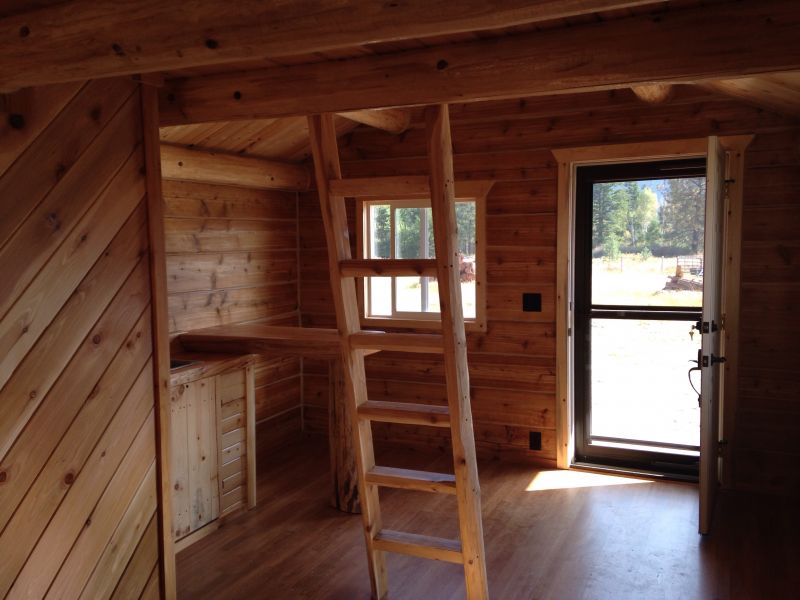

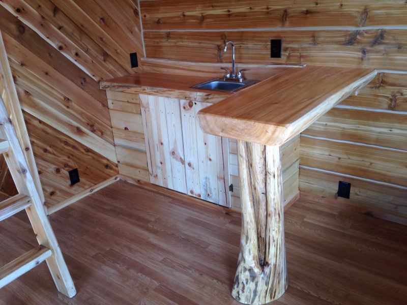

# Posted: 26 Dec 2016 11:10am - Edited by: DRR
I had Pergo flooring installed when my cabin was built in the summer of 2014. It still looks the same. No warping or any problems and it can get down to -40.
I've attached some early pics of the floor. Hope that helps.
