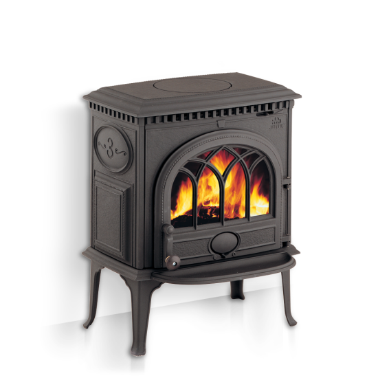

# Posted: 28 Dec 2016 10:35am - Edited by: Steve_S
My Jotul 3TD will be in the yard sale this spring needs a cleaning, stove black (or possible to change the colour if you want) and new glass for the door, which is around $90 or less. First dibs to our Cabin Folk here so if anyone "local" is interested... I'm between Pembroke - Renfrew areas. It all comes apart (unscrews) for transport, cleaning etc.... North of $550 + delivery if I have to trek far.
Looks like this below
Jotul 3TD Series
3 Series Jotul
3 Series Jotul

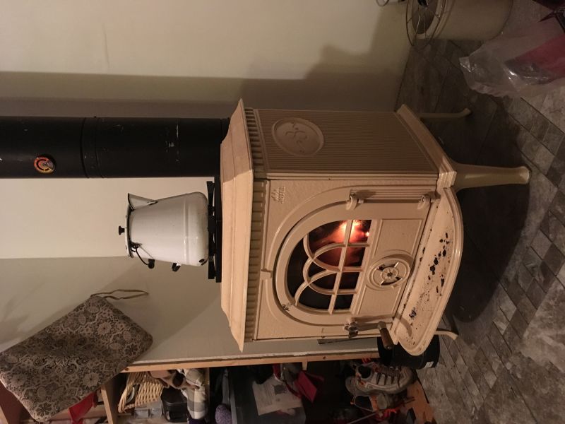

# Posted: 30 Dec 2016 08:13pm
The Shabin is 16X20 with a 10X11 loft. We found a Jotul Model 8 on Craigslist. So far it is working great.
Jotul Model 8
Jotul Model 8
