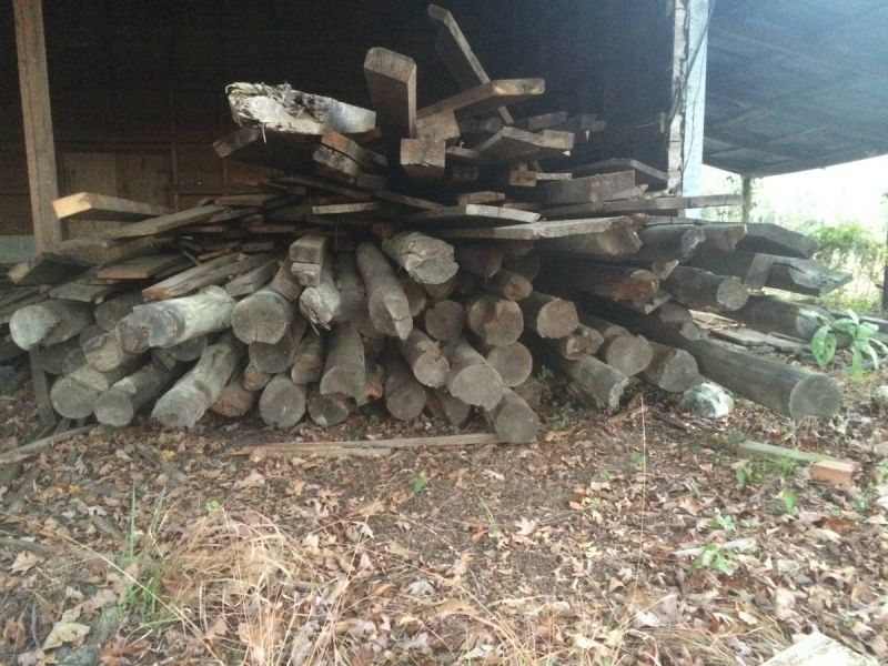

I found a guy, who was selling a pile of antique lumber. I noticed that underneath the lumber pile, was a bunch of logs as well. That was what I was really after, but didn't know the condition of them until I drove over two hours to get them.

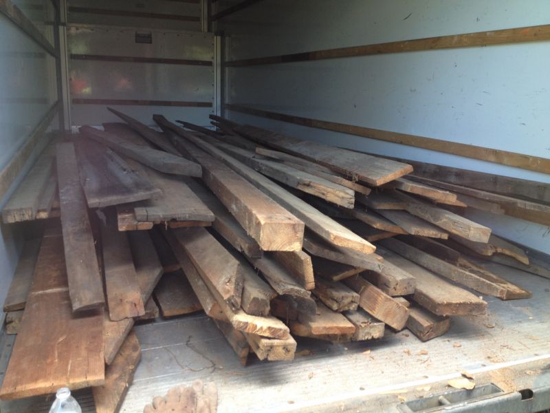

I didn't know how I was going to haul it all, and I didn't know the actual length of the material. I rolled the dice and got Uhaul's biggest moving truck.
I hired one extra guy to help pull and load all the logs and boards. It was one hell of a job loading all this by hand! The amount of dirt and dust was unreal.
There was a couple logs, that couldn't be saved as they were contacting the dirt floor of the barn area. I still have to inventory everything, but the plan is to build a 12' x 18' cabin on a skid foundation.
I am hoping to start the build just after winter, if I can get other projects done first. That is my son on the left, me in the middle, and Bob on the right.

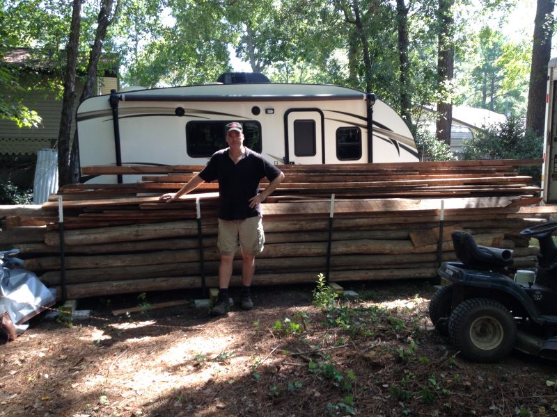

Over the years I have driven many fully loaded 26' foot moving trucks. This load proved to be the heaviest for sure. My son had to go back to college, so I had to unload it by myself and the wife.

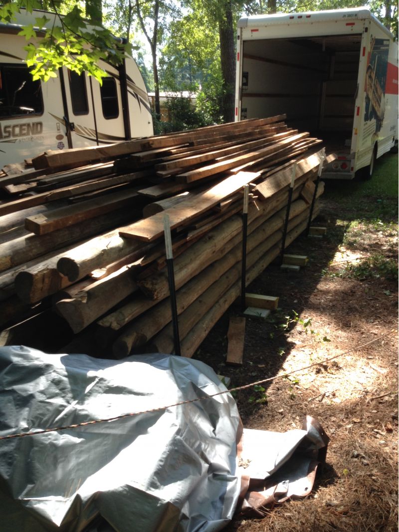

I stacked everything on pressure treated 4 x 4's, and drove in fence posts to hold the pile. I rigged up a pulley system so I could use my lawn mower to pull the logs out the back.

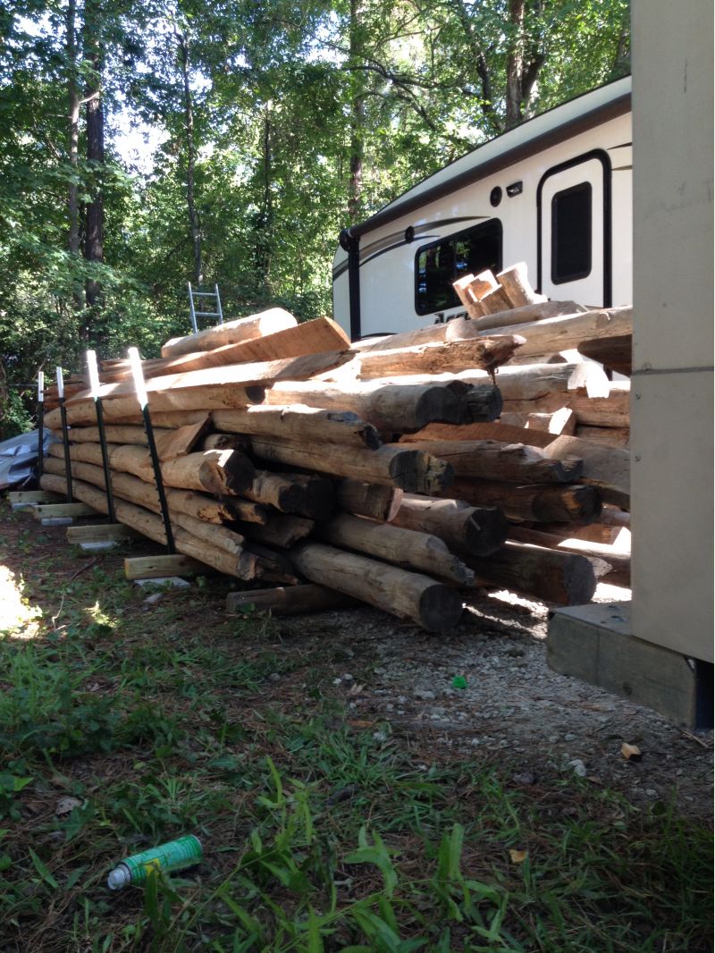

# Posted: 1 Jan 2017 11:00pm

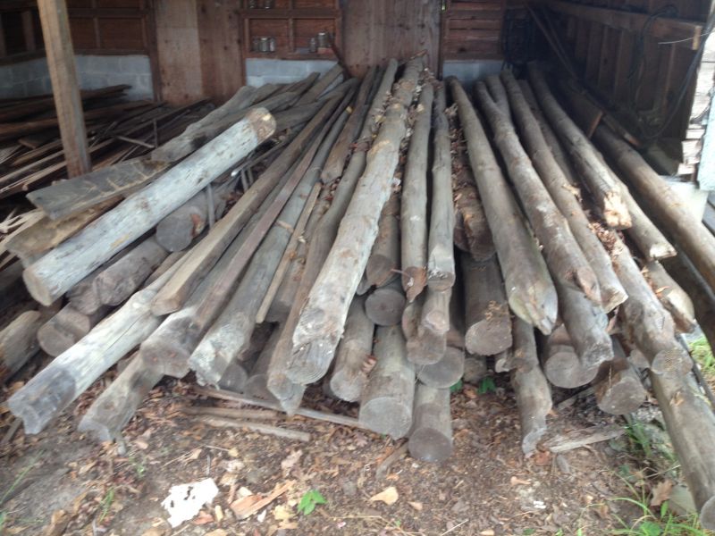

Now dat be a BIG pile o' wood!
The tobacco barn logs appear to have been used as poles, not horizontal logs in log cabin walls. I don't know much about tobacco barns but the few I've seen pics of were very open and simple pole barn type things- a roof to shed water and open walls to facilitate drying. Point is- wondering how you will use these rather irregular poles in a cabin? I'm sure you've got ideas- keep us posted.

If you look close at the picture you will see saddle notches near the ends of the logs, and some rafter logs.

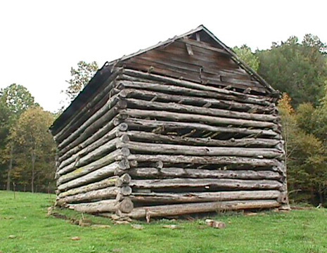

They were not poles, as nearly all of the logs have saddle notches on nearly all the ends. Many old tobacco barns here in the south, were constructed with unchinked logs just like these.
These logs are in such good shape, I think they ended up building a larger building over the top of it. This pic below is very similar to what it may have looked like

I stand corrected. I hope you can effectively use them to construct a building that is not quite so airy as a tobacco barn.

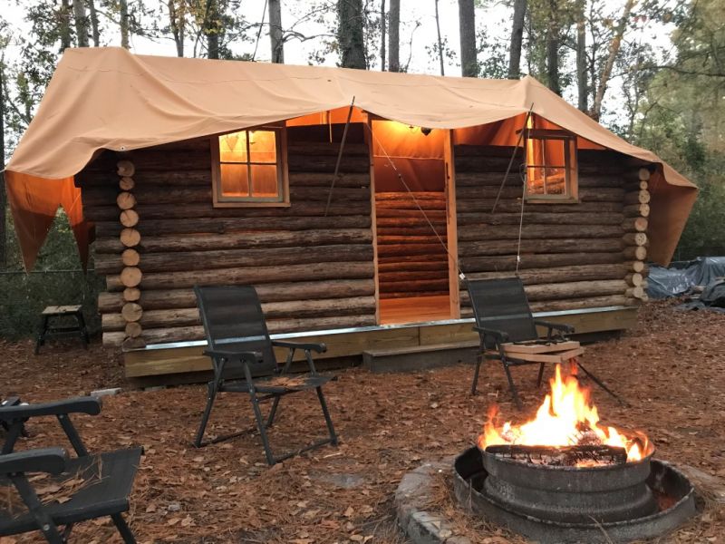

# Posted: 23 Apr 2019 05:37pm
I have been busy building this cabin

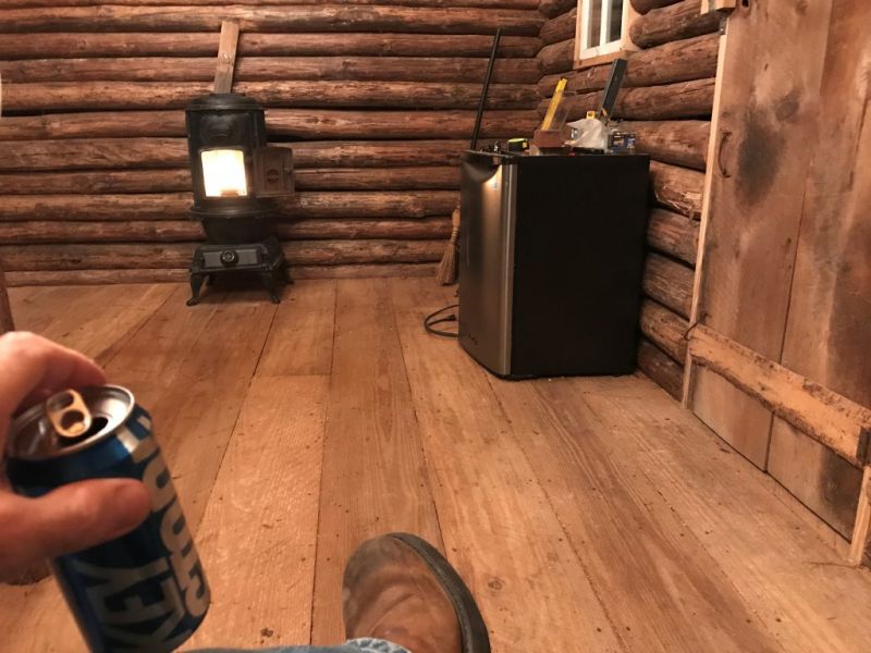

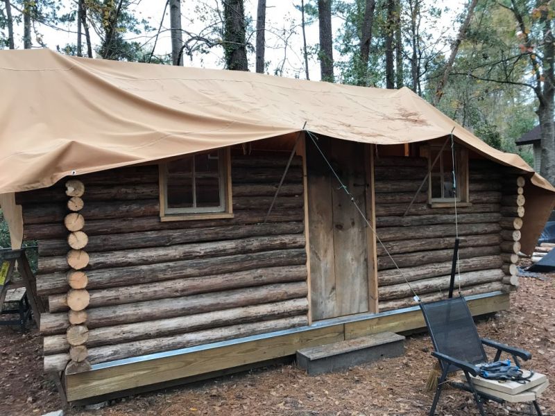

# Posted: 18 Dec 2019 09:39pm
Well, it's been moving along and almost done with log walls. I am documenting all this with pics and video as well.
