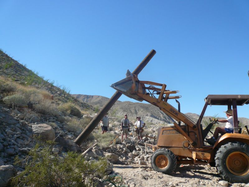

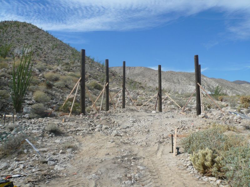

# Posted: 22 Jan 2017 02:54pm - Edited by: Borrego
I have also done a pole house using telephone poles, mine were closer to 12" in diameter and the main issue was getting them right on layout due to the rocky sandy ground I have at my build site. This is critical due to the fact that the walls sit right exactly inside of the poles and any variation will cause you problems with interior floor, drywall, etc.... I used R30 insulation in my subfloor and covered the bottom with plywood as you are going to do. If the method benny8 suggests will work, i would use it, not that I have had problems but just because it sounds easier and cleaner. Show us some pics, and good luck!
