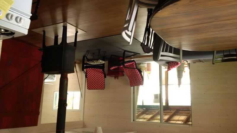

# Posted: 16 Mar 2017 08:13pm - Edited by: FishHog
T&G (low grade with knots) with a quick light white wash brightened it up a lot. I really like it.
# Posted: 16 Mar 2017 08:15pm
no clue why my pic's flip when I post them. They never used to but you get the idea.

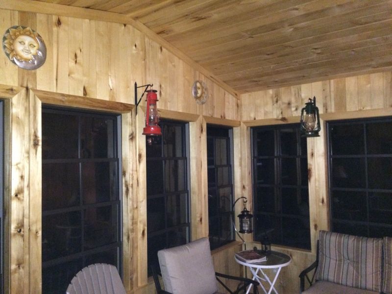

What I did was find a local sawmill and bought a trailer load of rough cut live edge aspen. Not sure how many board feet I got for $200 but the load was 6' wide 5' high and 16' long.
Took it home ran it through the table saw to get 5.5" and 3.5" boards. Stacked it up for a few weeks in the shop with a fan blowing across it and a dehumidifier running. Got it down to 12% moisture contact then ran it through the planer to wind up at 3/4"
After the planer I used a hand held router fitted with a router bit to cut the tongue on all the boards then changed the router bit to cut the groove. A hand held router at this step was the key to getting a consistent tongue and groove on the boards, because the router easily follows the contour of the board. This way warped or crooked boards can still be used.
I did all the trim and our screen veranda in a 2800 sq ft house and I'll be doing the same in the cabin. Total time invested was 12 hours of machine time. If you have the tools available, do it yourself.
# Posted: 21 Mar 2017 02:16pm
Wow - I never knew aspen (poplar) would look so good. Great work!
