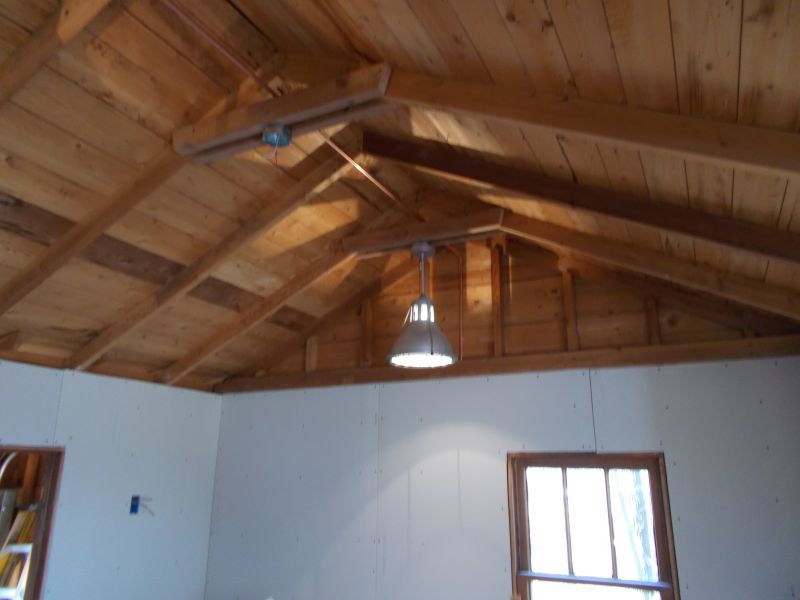

Its a strange situation, I actually have two roofs. The original cabin was a 1 room resort cabin built in the 40s, then a long time ago a bedroom and bathroom was added on the back and a room was added on the front, the original roof was left in place and a new roof was built over the whole structure..so when I took out my living room ceiling, the original room, I have a vaulted ceiling from the original roof,,, I hope that makes sense.
don62

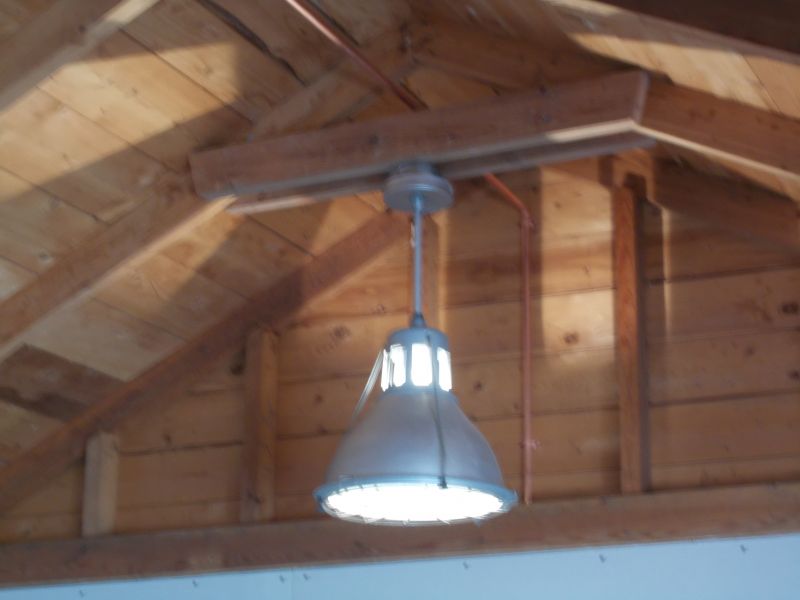

# Posted: 18 Jan 2017 01:55am
I don't have good pics of the original roof but this is the underside.

Nice ceiling! I hope you are thinking about screw length and the screws from the roof coming thru that ceiling - it will not look as good if they do. You may want to consider some strapping- whether you decide to strip the shingles or not. I would not strip them myself as long as there was only one layer.
