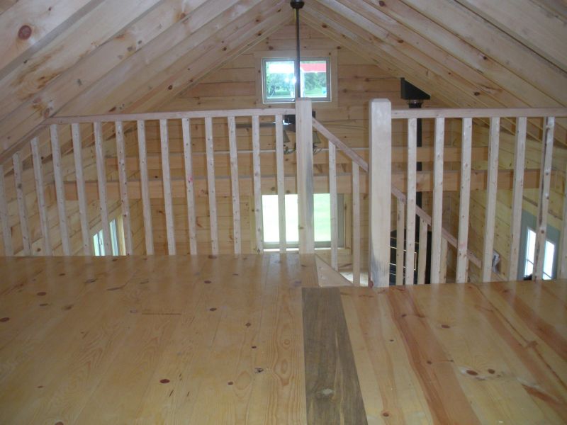

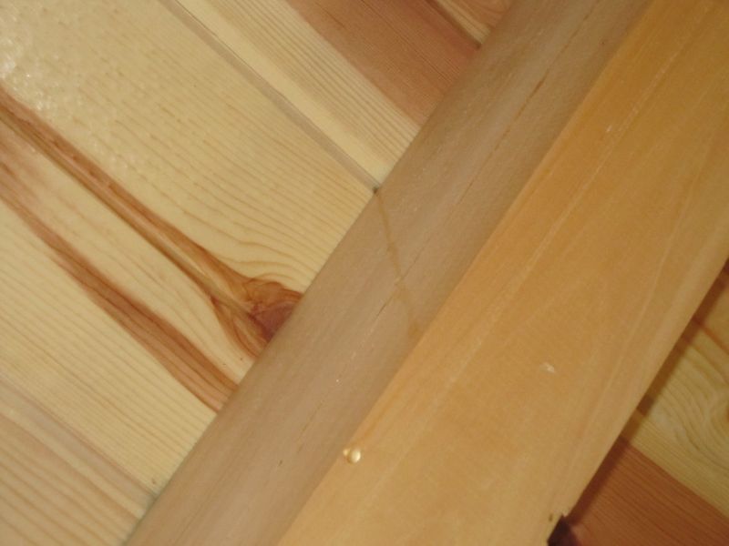

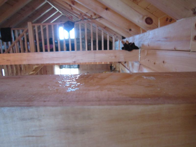

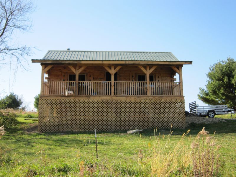

  Hello. Thanks for the replies. I will post some photos and that may help give a better idea of the roof lay out etc. I'm going to try and reply back to everyone's questions. Again thanks for your posts. There are no soffit vents or ridge vents on this place, which could be the problem =no ventilation. The roof is like this, I believe? Metal roof, sheathing? foam, which lays against the car siding. I don't believe there is any felt. If I had to guess I'd say there is no sheathing. The roof runs up and down. At the end of the roof there is a black foam type product which lays within the groove to keep the elements out and bees etc. check out photos. Thank you all. Scott  front view of canbin where we are having a problem with the roof.
  |   ceiling
  |   water dipping in on beam

  I wonder why we only have this problem on the front side of are cabin? This doesn't seem to happen on the back side?(thankfully)  Water(Moisture ) dripping in.
# Posted: 19 Dec 2010 01:38pm - Edited by: toyota_mdt_tech
  Yes, you have condensation under the metal roof. From the looks of it, be a simple job to add roof felt after removing the tin roof. A small team (good excuse for a BBQ) and you can have it done in a half a day. The ridges in the tin run vertically, so you have breathing under there to expel the water over time. Nice cabin I might add. Get it fixed, be a shame to see the roof rot off of it.
