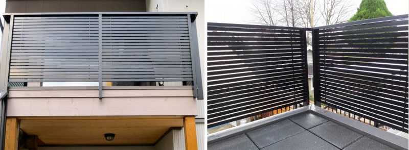

# Posted: 6 Feb 2017 01:17pm - Edited by: tichalet
This is a very nice looking aluminum system from Dekrail in Canada, IMO.
I have no idea how pricey it is or whether it's even available in SoCal, but I wonder if it wouldn't be too difficult to improvise a similar system with off-the-shelf aluminum railing components by excluding spacers. Or maybe use old-school aluminum decking planks (like you see in sports field bleachers & such) & just installing the "deck" vertically?
Anyway, just an idea or two I thought I'd throw in the great mix that you've already gotten for inspiration.

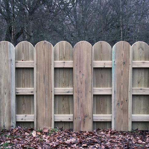

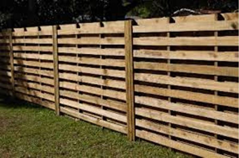

# Posted: 6 Feb 2017 10:51pm
Possibly Shadow Box style railing.

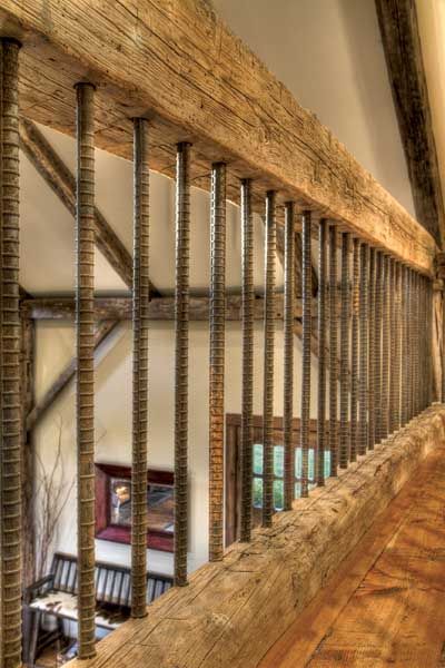

# Posted: 7 Feb 2017 05:37pm
We used rebar and hand rail material. This is not my pic but to give you an idea what it looks like
