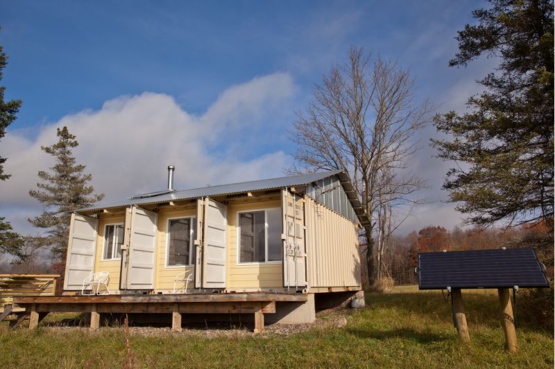

I like mine, but it's definitely more expensive to build than standard stick construction. I chose to build with containers for the security since my previous hunting shack was regularly getting broken into. I wrote a blog post years back (see link below) that discusses the financial, as well as other, considerations of building with containers.

Steve, good to "meet" you. I have read your blog many times over, very well done. It is the best implementation I have ever seen and certainly the best documented.
Your blog actually helped convince me not to go the shipping container route, for many of the same reasons you outlined. The modular aspect and the security benefits though make a very compelling solution for anyone in a similar situation.

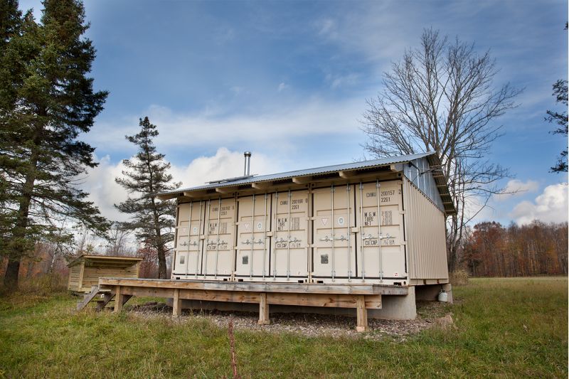

Steve, what was the reason to have the containers so high off the ground? I need to use three containers also for security and a few other reasons. I am thinking concrete slab. I am also trying to engineer some underground storage accessed from the inside but not sure how. Side note: Have you seen Andrew Camarata's castle?
Steve961
# Posted: 30 Dec 2021 01:18pm
Quoting: DaveBell
Several reasons.
1. Snow. My cabin is in northern Wisconsin and I didn't want it to get swallowed by snow in the winter.
2. Critters. Since the cabin was going to be elevated anyway (see #1 above), it had to be high enough that animals didn't find it attractive for nesting underneath.
3. Ease of access and upgradeability. It's extremely easy for me to get underneath to add a wire, gas line, pipe, etc.
I have seen the castle and think it's neat, but it's definitely way more than I need. It also has more points of potential intrusion than I would like for mine.
