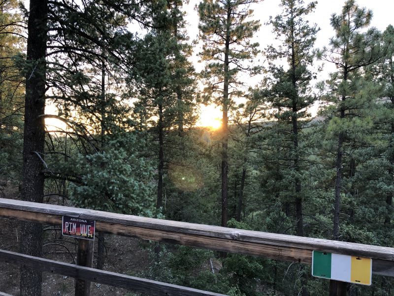

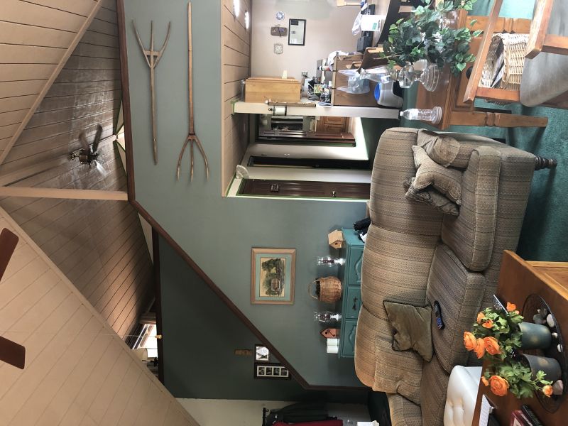

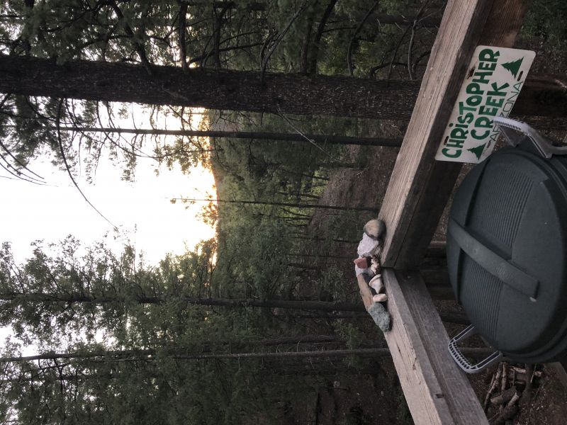

Thank you all for your post. I checked with the county to see if there were ANY permits on this structure but so far there is nothing.
Just sending a few positive photos of the cabin.
Please keep the comments coming. We need all the help we can get.

That's a nice cabin but it's very saw that it's set on that foundation.

Our "City Home" is just down the hill from you in Payson... if you are where the sign on the deck indicates. Certainly not 100% sure but I would think you would have some pretty solid soil under there, not that far down. Have the footings... assuming there are footings shifted as well or is the mortar cracking and the columns are just leaning? That area is pretty dry and not prone to landslides or shifting. Pretty stable ground.

If they are in Christopher Creek, the frost depth is only 12" - 24". We are talking AZ here even if it is in the mountains. They only have temps in the 90's there all summer instead of 110 -120 in Phoenix. People from Phoenix see that as a cool retreat!
