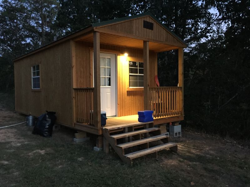

Cabin
Cabin
Cabin

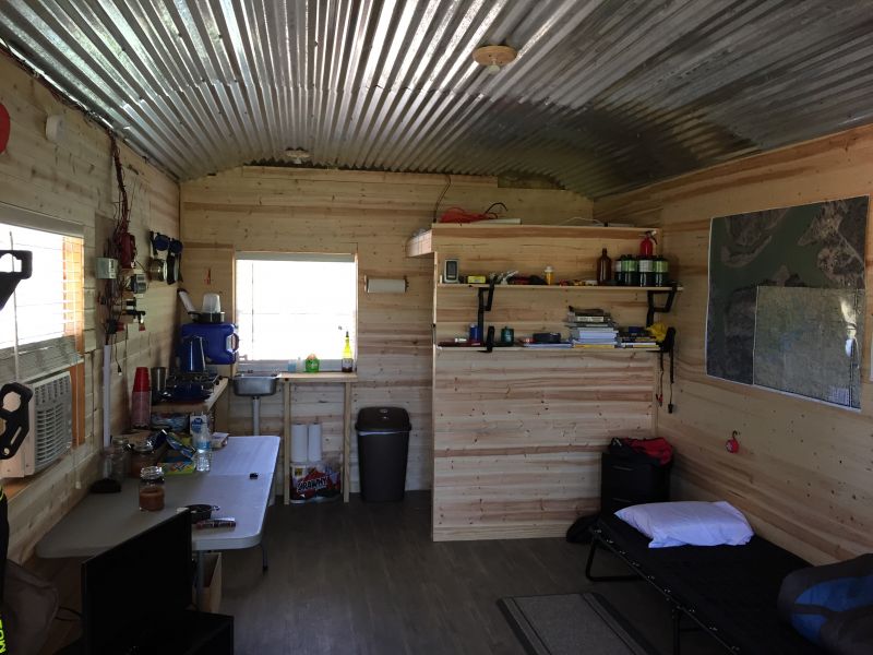

Inside
Inside
Inside

Very nice place, thanks for sharing.
# Posted: 8 Apr 2017 05:29pm
One of your cinder blocks is sideways.

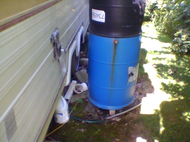

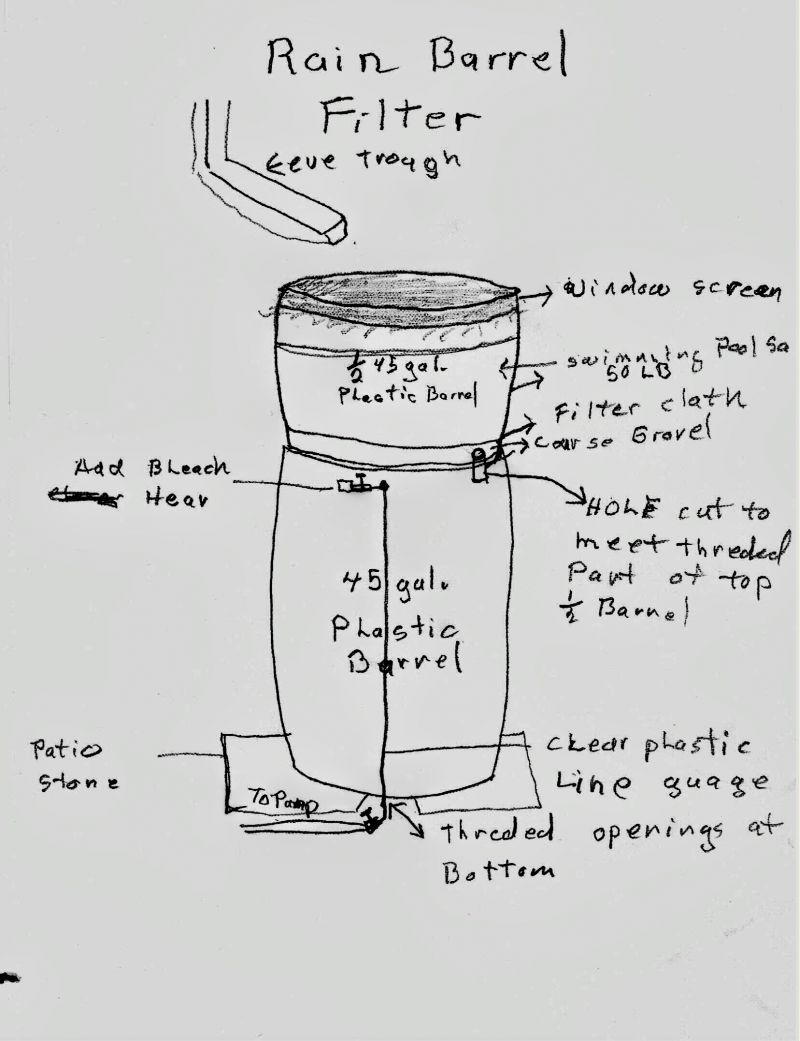

This one works for us .add a bit of bleach once a week , we even drink it .the missing word is [ pool sand ]..
