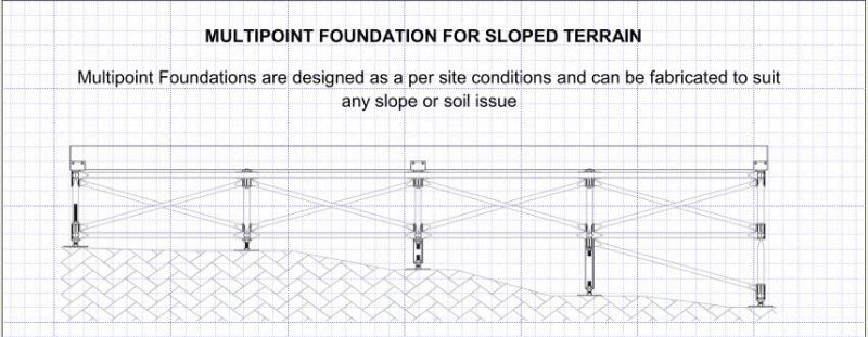

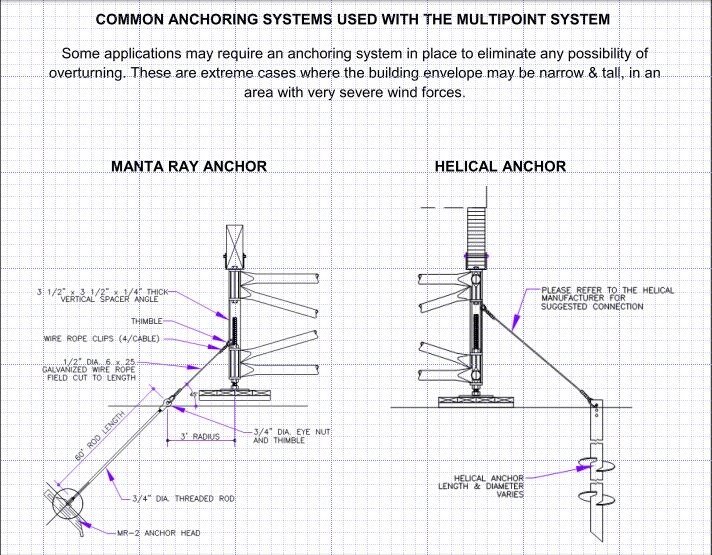

  How much do you want to spend on the foundation? I plan on using a space frame which will run about $12000. It might be perfect for your site as it can be designed for a sloping terrain. There is no excavating, formwork or concrete involved and you can anchor the frame to your site.
  http://multipoint-foundations.com/

# Posted: 17 Apr 2017 11:18am
  I won't have the funds to buy a 12k  foundation. I am just gathering supplies from local auctions and will be doing this for as cheap as I can. I have 2 kids and another on the way so cheaper is better. Lmao    I did however get 600 dollars worth of new windows at an auction this weekend for 45 dollars. Woohoo!
