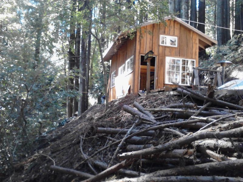

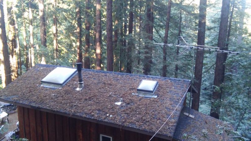

See photo. My cabin is surrounded by tall redwood trees. They have a habit of dropping branches, long straight things that come down like spears. Before I built I had a climber spend a day breaking off any suspects. Since then two have dropped onto the roof, fracturing the shingles and sheathing. Not much I can do about it, wonder what others living under them do.
The 4ft. skylight sits right over the bed. One of my favorite pastimes is laying there wondering if we would survive.. So I'm wondering how to protect it without killing the light it provides. A metal cage on the roof? Expanded metal or fencing on the inside screwed to the rafters?

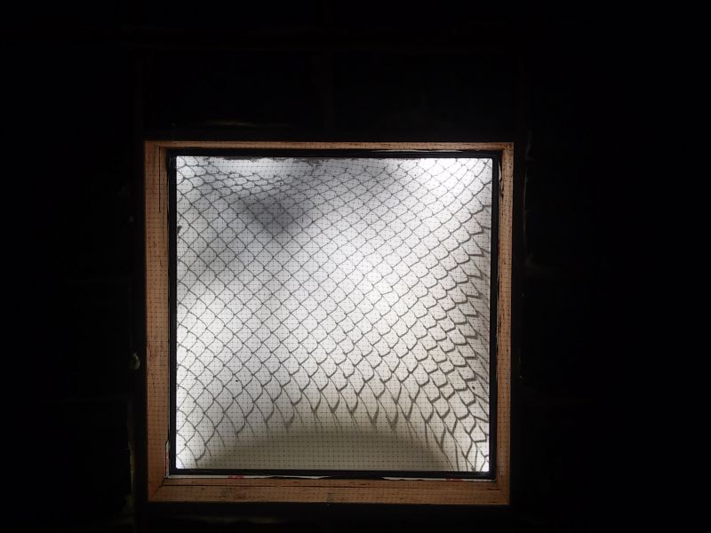

Great when you find a use for something you have kicking around. I found a piece of wire fence behind my shed exactly the right size. Nailed it to the sides of the skylight. Not pretty but hopefully effective.
