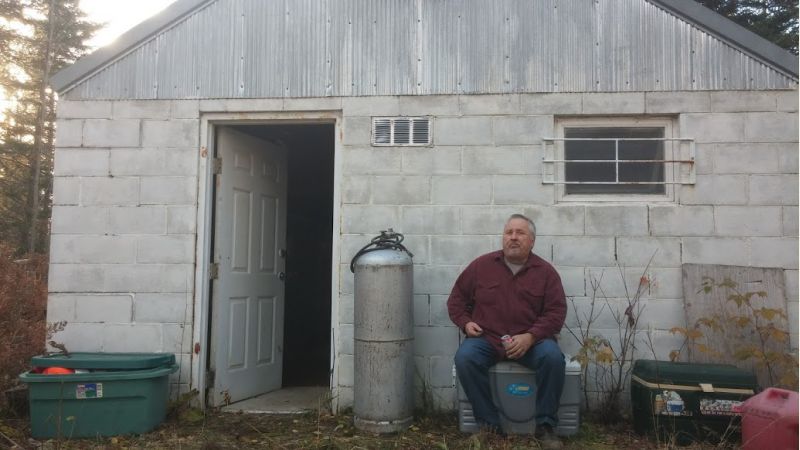

# Posted: 27 Apr 2017 10:40pm
This is all I have right now. Probably won't show you much...
# Posted: 27 Apr 2017 11:29pm
Problem is that if you put pony walls on top of the block, there's no way to support them laterally. They could hinge where they contact the block wall. I'm sure an engineer could come up with some sort of braced solution here, but that's going to cost money. Also, depending on how your uncle built it, it may not have enough strength to support additional floors, heavier roof, whatever. If the concrete blocks are empty and have no rebar and grout, the walls are very weak. With rebar and grout, and a good foundation, they are very strong.
I'd do more investigating before I made any decisions.
