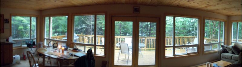

I love shopping the "used building supply" stores. You can find new windows, never installed at huge discount. Stuff left over from huge construction projects, factory seconds, etc. just ask why each window is here. I have this 4' x 6' top of the line (gas filled void and coated exterior glass) that I put in my cabin, cost $ 50. It was a left over from a commercial project in Florida and I think it is the hurricane resistant glass. Shop long and hard, stockpile what you need and great prices and just keep walking on all the rest.
