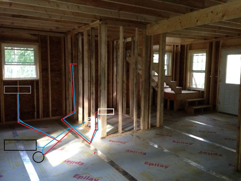

So we will have a 45 gallon storage tank hooked up to a shurflo 110v pump going to a small 6-10 gallon water heater. Kitchen sink, shower, toilet, bathroom sink are all within 8 feet of the pump. Do We need different size water lines or can we go with 1/2 inch throughout? You guys were great help with the waste/vent lines and we got 80% of that installed last weekend so thank you!

I'm similar and 1/2" works great for me

Usually supply from service to house is 1", main trunks in house is 3/4" ie in and out of hot water and everything coming off those is 1/2"

I'd use 3/4 for the trunk lines and 1/2 for the branches. That will reduce pressure drop when two fixtures are used at once.

I believe the normal practice is 2 fixtures on a 1/2" line, any more get 3/4" line. If its a small place and no more than 2 things would be running at once, 1/2" may be enough for your use. Not sure what the price difference is, but its relatively easy to size it correctly at first than be frustrated and wish to change it later.

The 1/2" lines will strain the pump more than the 3/4, because smaller lines have more resistance. My water source is a storage tank up hill that delivers only about 16-18 lbs pressure. I'm using 1" poly trunk line and 3/4" copper for all branch lines because the larger size will give me better flow at lower pressure. 3/4 pex is probably not much more expensive, particularly with a small system. I'd go with 3/4 throughout just to make it simple and ensure good water flow.

bldginsp, is technically correct. but with 8' runs, it so minimal it won't affect the pump. 3/4 throughout is certainly a good option, but my 1/2" system with a 12' run and a 20' run works absolutely fine. I think were splitting hairs. IMO.

Well that's good. I bought the fittings yesterday and we are going with the 1/2". We have dry camped with an RV on the land for 10 years and are pretty skilled at water conservation so I think it will suit our needs. Just want to thank everyone that weighed in on the issue- we'll let you know how it goes.
