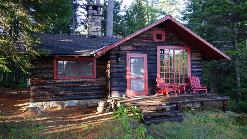

  Our cabin was partially painted with water base paint/stain....not exactly what I would have done...plus its only partially painted, they didnt complete the job.
  Is there a way to transition to an oil base stain/finish without stripping the old paint?

  What did they use to get the logs to look this way? Way rustic look...almost black.

  We used Symphony from Sashco on our interior logs. What an excellent product! I highly recommend their stuff. http://www.sashco.com/log-home/
# Posted: 4 May 2017 05:06pm
  Waste motor oil?
Murphy
# Posted: 4 May 2017 08:23pm
  Thanks for the info!
  Your right...it looks like a railroad tie almost. Guess they used whatever was available... This cabin was part of the J P Morgan estate thats for sale.
# Posted: 4 May 2017 09:11pm
  YW. Did more research it could be this also. http://npic.orst.edu/ingred/ptype/treatwood/creosote.html  Either way removing it would be very unhealthy and as far as my thinking goes the logs are ruined and chemicals have leached into the ground over the many years also causing a health hazard.  Very sad.
# Posted: 5 May 2017 01:31pm
 Quoting: Murphy What did they use to get the logs to look this way?Way rustic look...almost black.
  From the photo it almost looks like there is no finish and the black is mold/mildew.  I say that because it doesn't look like they peeled the logs.  Looks to me like areas where the bark fell off are black, other areas still have bark are not black.
# Posted: 5 May 2017 08:25pm
  I would bet  lynseed oil ,common years ago.
Atlincabin
# Posted: 6 May 2017 09:36pm
  Linseed oil mixed with diesel was common as a cheap log finish many years ago.  Talk about a flammable mixture! I used Osmo on the interior of our cabin.  A lot of work putting it on, but looks nice and is environmentally friendly.  A friend did similarly 20 years ago and his logs look like new on the inside.
