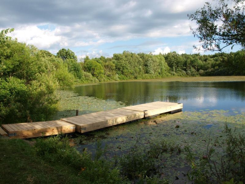

We did a 32 foot long dock in three sections. First is hinged at land. Other two are attached in the summer and have the tire chain method. In the winter we remove and drag the short piece onto land. The longer sections free float attached to the bottom of the lake to move with the ice. This is in western NY where snow and ice are common. It has been installed since 2014 with no issues. We contacted a guy at the EPA and he advised a tire at the bottom of the lake will do no harm.
