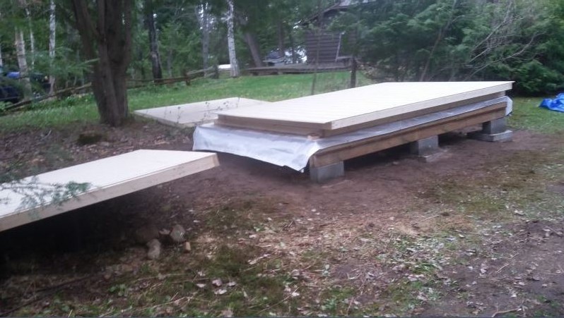

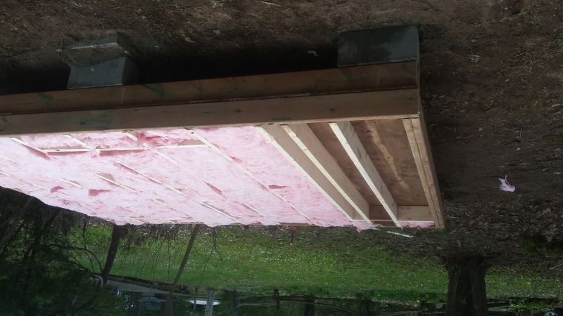

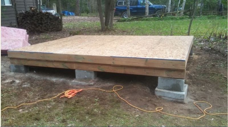

Posted: 22 May 2017 08:47am

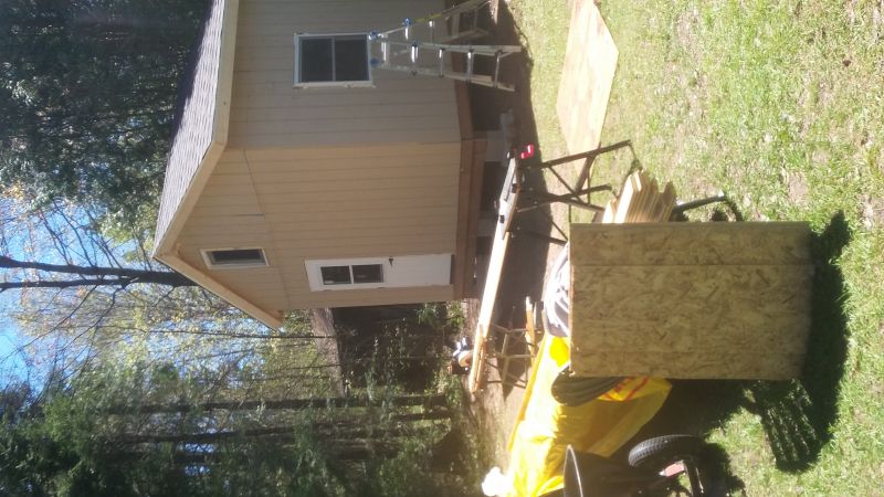

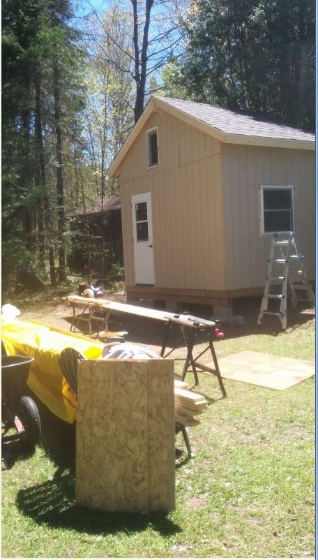

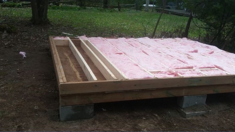

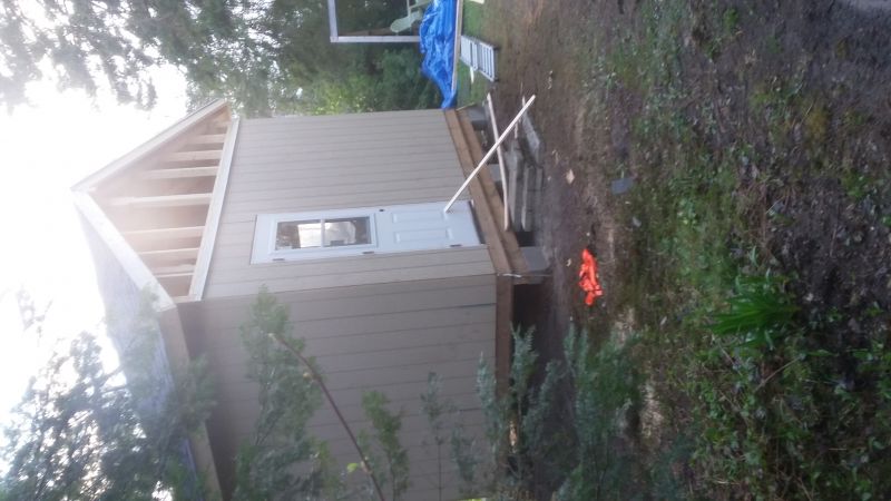

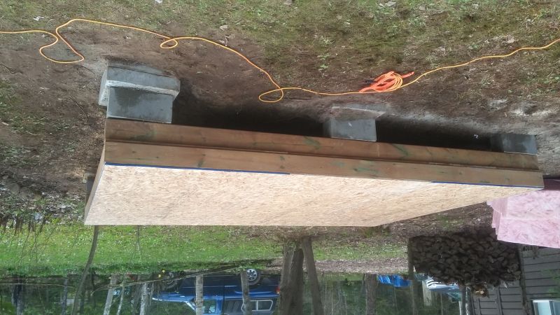

day 1& 2
gunner1198
Posted: 22 May 2017 09:19am
Australia?
Posted: 22 May 2017 09:35am
you got it dumb cell phone
Posted: 22 May 2017 09:40am

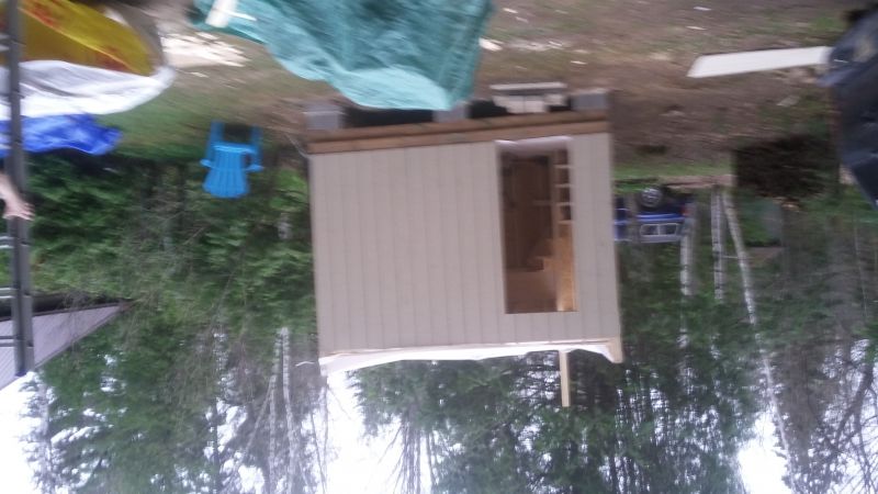

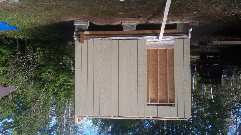

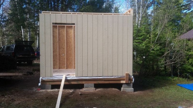

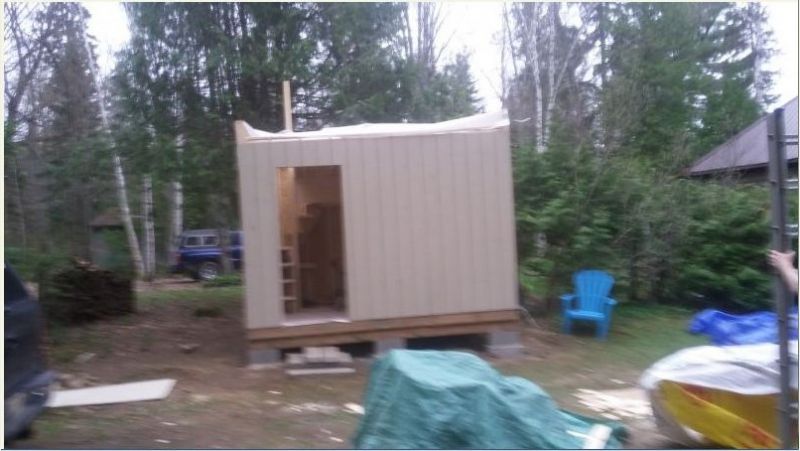

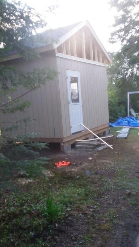

try again day 3 & 4
Jabberwocky
Posted: 22 May 2017 09:48am
That's incredible how you Aussies manage to build upside down like that!
Posted: 22 May 2017 09:58am

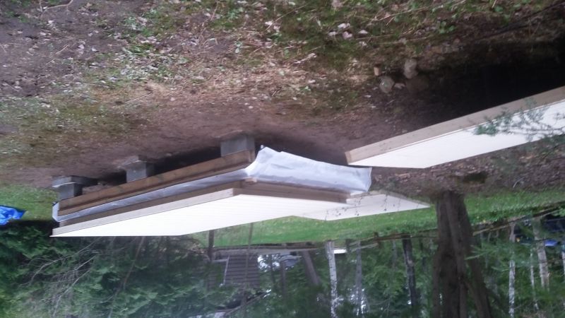

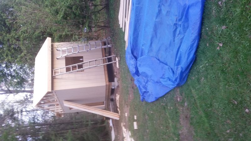

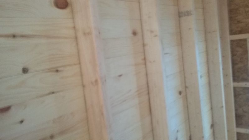

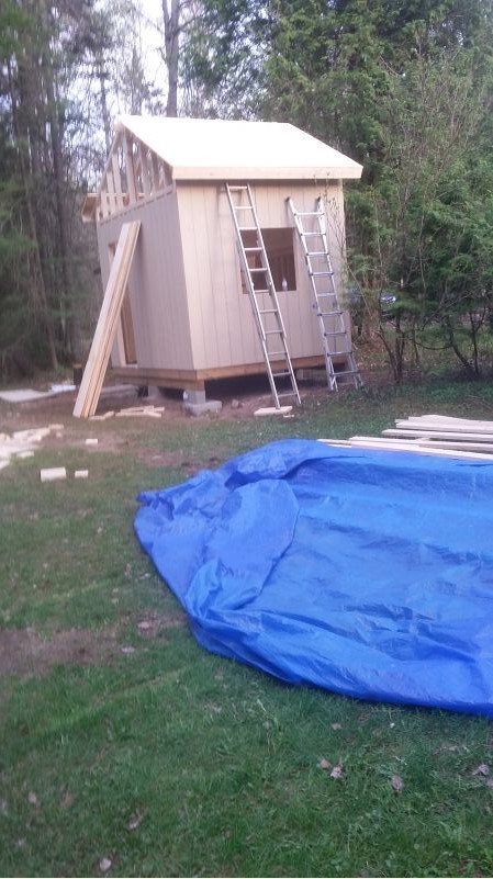

5 & 6 & 7
1
2
3
Posted: 22 May 2017 09:59am
I give
Wilbour
Posted: 22 May 2017 12:44pm
How's this...
Wilbour
Posted: 22 May 2017 12:49pm
And this...
Wilbour
Posted: 22 May 2017 12:51pm
And finally this..
Jabberwocky
Posted: 22 May 2017 04:17pm

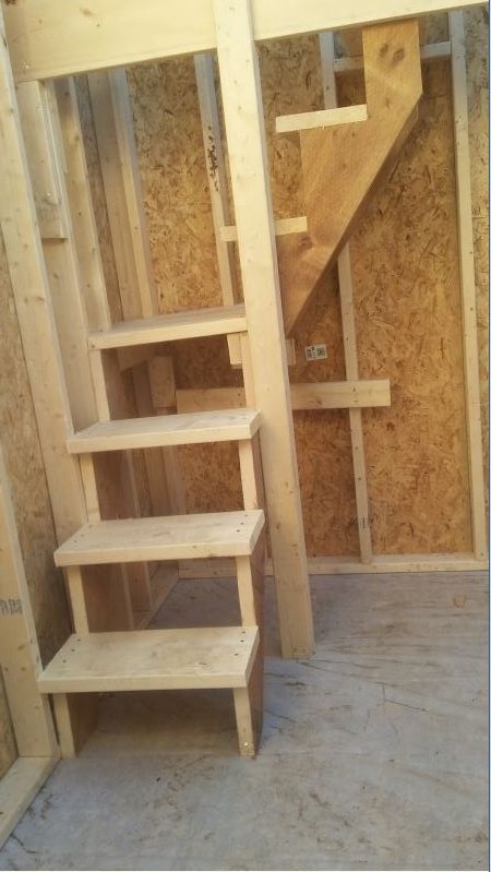

Really like those stairs! So what's it going to be used for?

Wow, that is TINY for a family of four. More power to them!
Posted: 23 May 2017 12:08pm
no choice in Ontario 108sq ft. max . for weekends only.

Those stairs are just......awful.
Sorry. "Death-traps" was my second choice. The rise must be at least 12 inches (7 1/2" is usually the max recommended). Little children are going to be going up and down those? The treads overhang the riser far too much and will become tripping hazards.

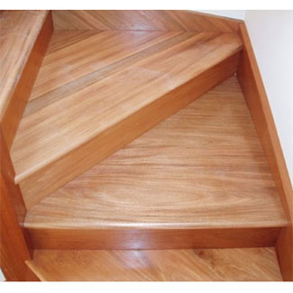

For the sake of safety (and peace of mind) I would decrease the height of the steps and turn the landing into a "winder". This will add one more step to the staircase but make it very safe.
The easiest way to build a winder is to build a square landing and attach it at the right height to the exterior walls and that post. Then build a triangle shaped box and place it on top of the square landing. Attach the lower and upper straight runs of steps to the landing and you're done.
Winder Landing
Posted: 23 May 2017 08:32pm
10 in. actually it was ether that or a ladder they chose the steps.
I did add kick plates and a railing before I left,but you are correct they are not the best.The run and the rise add up to 18in.

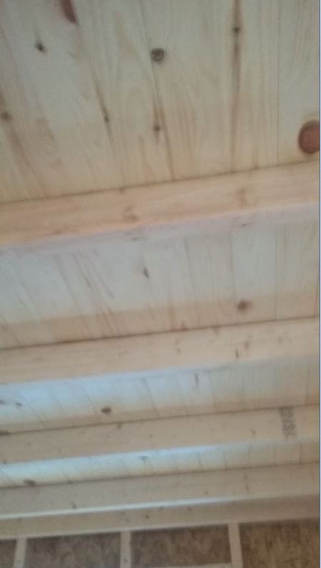

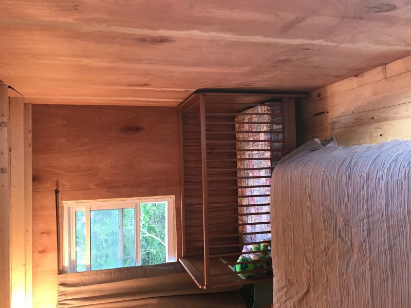

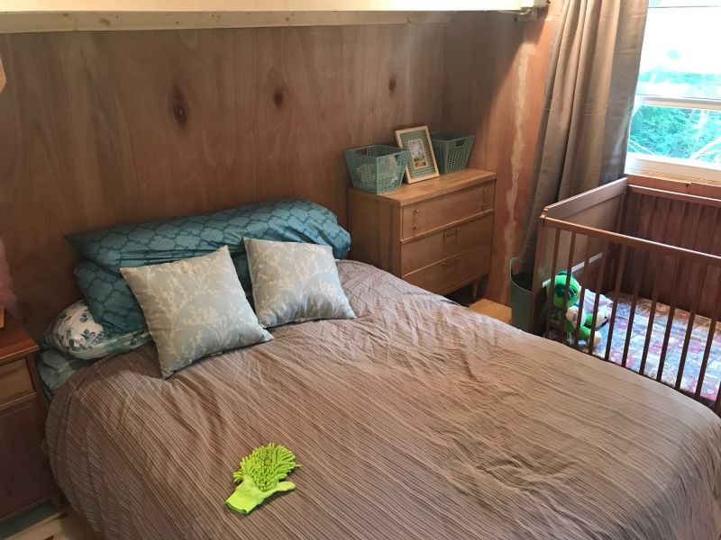

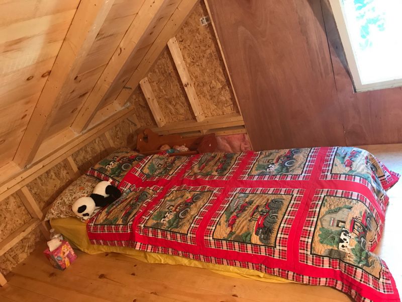

Young family has moved into the 7 day build. They sent me these pics tonight . Nice to see it has worked for them .
Posted: 19 Jul 2017 10:34pm
pics
down stairs
pine floor
loft

What's the dimensions of this cabin?
sparky30_06
Posted: 27 Nov 2017 06:51am
are you worried about moisture being trapped under the floor with the insulation?
Posted: 27 Nov 2017 08:58am
Go 9x12
sparky 30 06 summmer use only hope not..pt bottom

Nice interior, sir Just
'course I'm partial to wood
