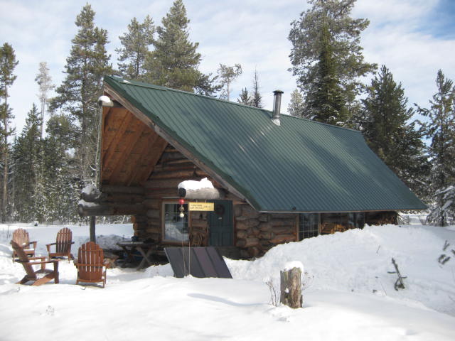

I went into the building department and told them I was going to cut down some trees on my property and stack up a small building to store some things in. They said "oh, you are building a pole barn". The requirement was a sketch to show proper set backs and a $5.00 building permit with no inspections at all because I didn't have any power or water. I didn't tell them I was going to store myself inside the structure and they didn't ask.
my 24 x 14' cabin
my 24 x 14' cabin
