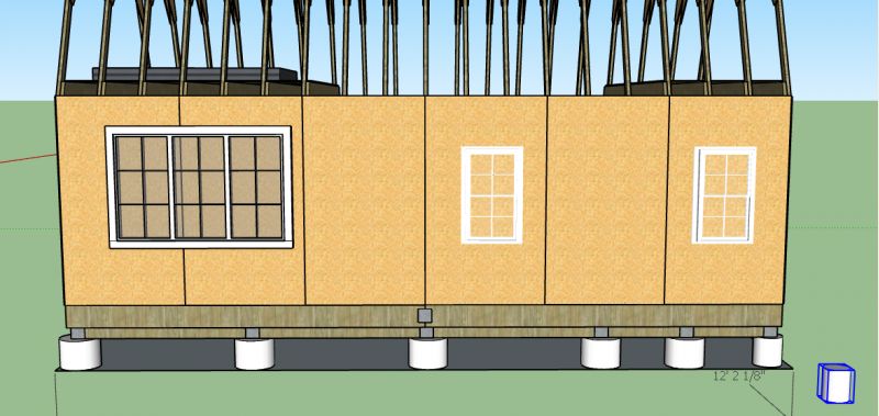

See attached pic.
It is going to be my retirement homestead so yes....I want it to last for many years. The frost depth is 22 in. So I'll dig down 22" + 6"...correct? How many inches of rock do I pour down the hole first? Does this count toward the total depth of 28"?
My plan is to dig 10" holes (I have an auger) and place my 10" tube into it and start filling with concrete. However...that is a lot of concrete! I don't have experience in this but I have a good understanding (youtube) how to do it and do it right. However...I am confused regarding IF I need to put rocks at the bottom.
Also, the flared base, would cause me to widen hole and I would have to do that by hand because my auger is only 10" wide.
So what is the best way, least expensive and low labor? I do want to do it right but I have to completely do it on my own and I am turning 50 this year. lol.
PS...Don't pay too much mind to the smaller footing. I'm adjusting the size of the footing to 10" (12" is a little much...I think). You let me know if it is a good size please.
# Posted: 8 Jun 2017 09:00pm
That's a lot of footings along the length of the cabin (six?)
You should be able to get by with 3 (what size is your perimeter beam?)
I would go down 36" for your footing tube just to be safe.

# Posted: 8 Jun 2017 09:06pm
Perimeter is only 12'. I'm going to have 2 - 55 gl. drums in the loft on the right side. I thought I might need the extra footings for the weight. I could drop it down to 4...3 + one extra on the right side for added support?

# Posted: 8 Jun 2017 09:13pm - Edited by: rockies
Well, if you're going to have drums like that on one side (up in a loft) then one more pair of footings on one end (mid-span between the center pier and the end pier) wouldn't hurt. Just place the extra piers under the point where the loft support studs come down (the "Point load").

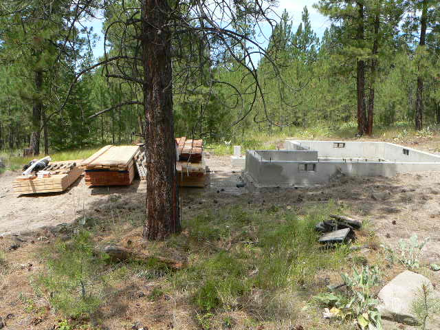

M/M, is there acces to get in a tractor and cement trucks? If so, the full footer/stemwall is actually much less labor. I did it because it was so much easier. I did hire out the foundation after the site was prepped, ie he did the forms, rebar, called in inspector, then called in concrete. I showed up to build, I have a nice footing stemwall in place. It cost me about $3800 for it all. Good value IMHO, never a single critter has gotten inside of it yet. It will still be in place and level, long after I have assumed room temp. I showed up to my place with lumber pkg in place and foundation all done. It was a breeze. If you do go this route, I would backfill the foundation before starting too to final grade. Mine wasnt and it made everythign in the front real tall.
My concrete guy did install a 4" drain tile under the footer at the lowest end, so if water ever did end up in there, maybe form a pipe burst or whatever, it would all drain out easily. My area is so dry, there is zero moisture and its graded and sloped right, lots of gravel under the cabin and a nice black vapor barrier.
