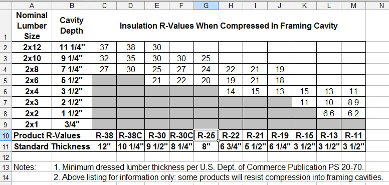

Using Owens Corning information... (other brands may differ)... Standard R30 fiberglass insulation is 9 1/2 inches thick. However R-30C, made for cathedral ceilings, is 8 1/4 inches thick.
The R30C would leave the minimum recommended 1 inch for venting with a soffit and ridge vent. R30C is sometimes hard to locate, may need special ordering or may be available through insulation contractors, although they may not want to just sell the batts.
The following chart mat be useful when choosing fiberglass insulation. Note that when batts are compressed too much the R-value goes down. compressed insulation chart

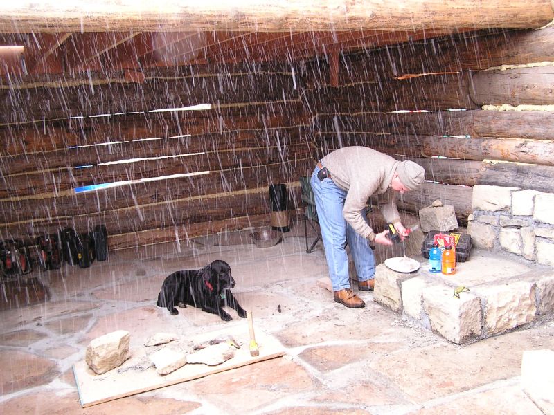

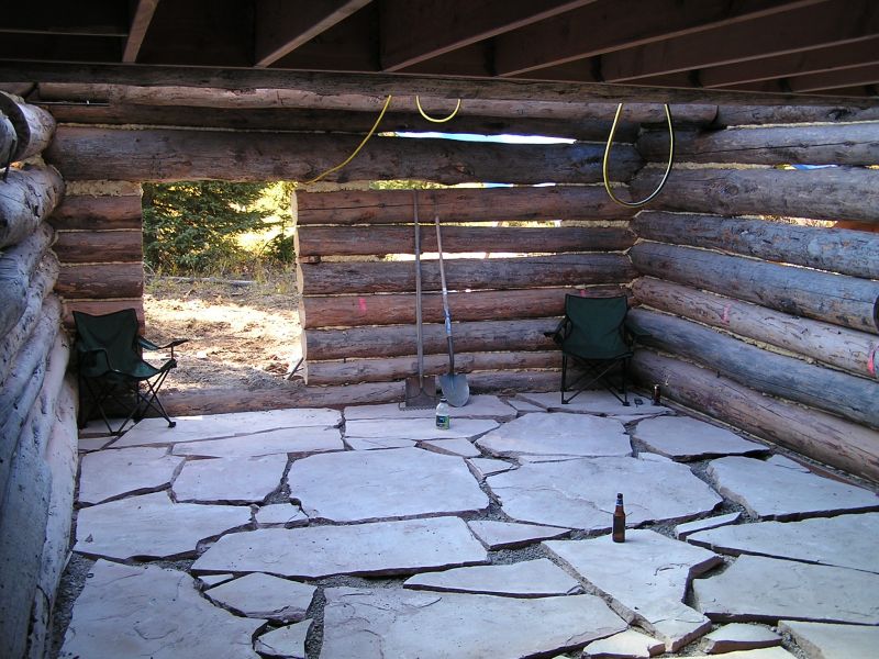

I layed a stone floor. Excavated out 36" of subsoils, replaced with 3/4" crushed stone, added a skiff of smaller 5/16" crushed stone then installed stone slabs which I motared in place. I was just up there and the outside temperature was 11 degrees F, the inside temp at 5' off the floor was 30 degrees F. The crushed stone allows the ambient temperature of the Earth to radiate up and prevent things from freezing at the floor level when I am not there. I only have heat when the wood stove is fired up. I have consistantly noticed that the inside temp is +/- 20 degrees warmer than the outside during the winter and +/- 20 degrees cooler in the summer months. So if you are considering a stone or brick floor consider doing this it has worked well for me. Stone floor pre-motar
|  Stone floor post motar
