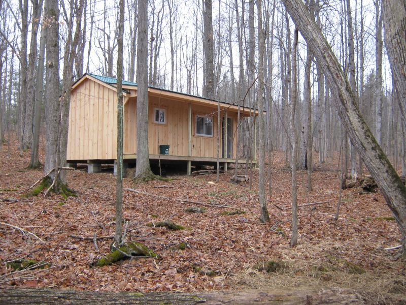

cman47c
# Posted: 5 Jul 2017 09:07am
We built this 14 X 24 cabin in 2008 on blocks laid on small indentation in rooted ground with some gravel. Has not moved in 9 years. Not AK, but do get cold winters/snow.
