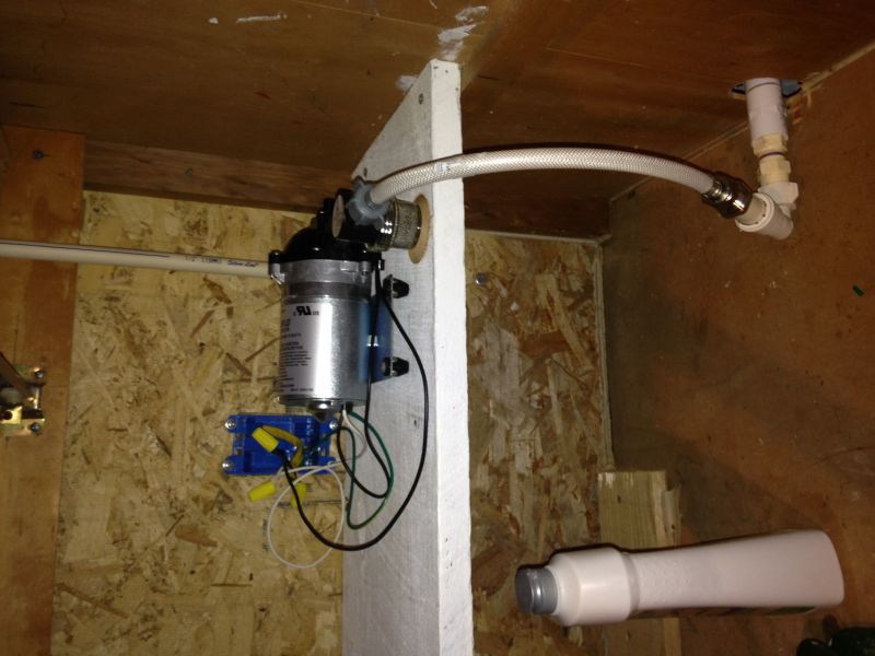

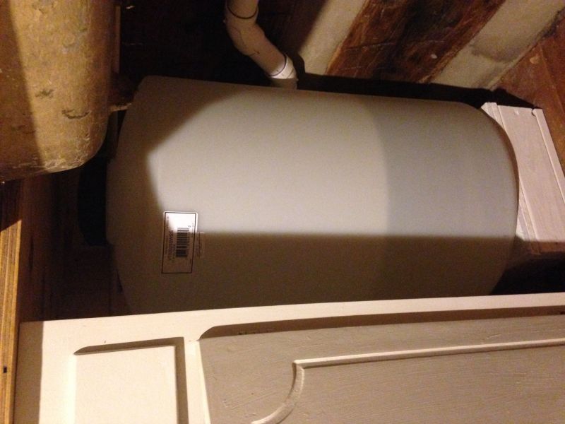

  Man it feels great to take a shower, wash dishes etc. Makes staying there 100 times more enjoyable. I ended up setting up 2 55 gallon rain barrels. They're black to avoid growth of anything as they sit. I have a 25 gallon cistern inside that I transfer water to (kind of a pain but worth it). Then I use a Surflo on demand pump to run the kitchen sink, bathroom sink and shower (it's a bit loud but no big deal). I have a 16 gallon electric hot water tank. Pressure is great. I need a lower flow shower head as I'm using about 5-7 gallons per shower.  Cistern.JPG

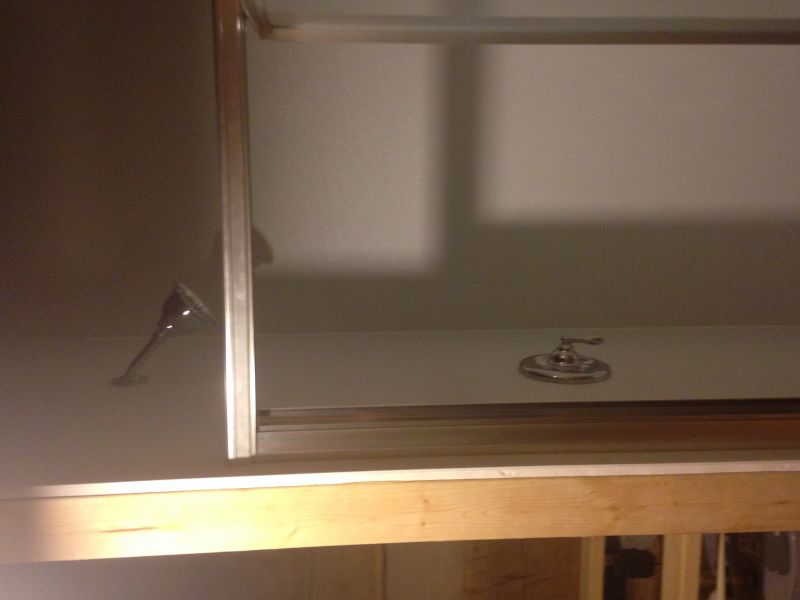

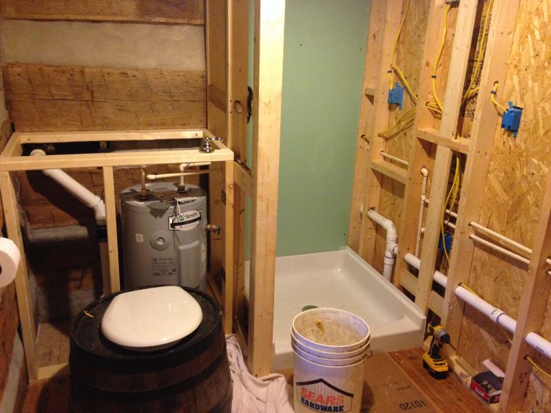

# Posted: 18 Jul 2017 07:59pm
  better pick of the hot water tank/shower
