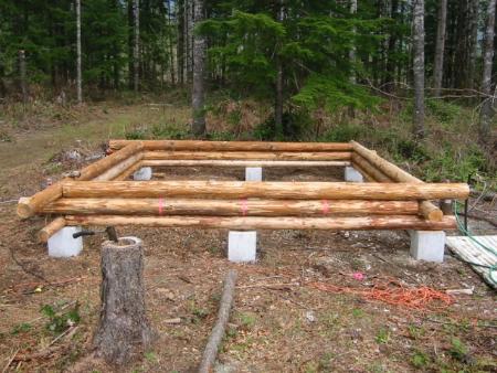

rockies,
The attached image is just one I randomly pulled off the web, but it illustrates what I'm talking about. I want to raise off the ground to prevent rot in my bottom logs, and don't want to pour a full slab, so I was wanting to do this as a happy medium between cost and efficiency.

# Posted: 8 Aug 2017 08:22pm
This looks like a very bad foundation for a log cabin. Log structure have a great deal of weight along the entire perimeter wall. What happens at the points where you want to cut in a door? How do you install a floor?
At the VERY least I would prefer that if you decide on a foundation such as this (concrete piers resting on footings which should go down below the frost line) that you install a squared off structural perimeter beam (maybe 6" W x 12") on top of the piers (this will also provide you with a place to hang the floor joists) then a plywood subfloor and then build with logs on top of that. At least then your floor will be stable and level.

Is there another foundation that would be BETTER? We're definitely looking to build this right, but we also have a moderately limited budget. I read that I need to get it off the ground to avoid rain splashing onto the logs, and to me this was the way to do that.
# Posted: 8 Aug 2017 09:52pm
I would probably use something like "The BigFoot Tube" with a expanded footing cone at the bottom to help spread the weight around. I'd probably use the biggest size tube as well.

A squared on three sides foundation perimeter beam will give you a place to attach the floor joists.

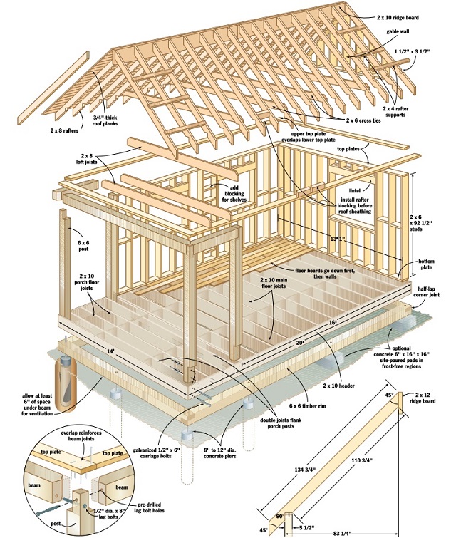

I'm not a big fan of log homes. Everyone watches that PBS special "Alone in the Wilderness" about the guy building his own log home (and everything else) using simple tools and they think "I could do that".
Maybe you could, but you must remember that he built himself a bare minimum cabin - no running water, no electricity, no appliances. Today most people want a bit more "city" in their country, and no greater proof of that is when the single guy builds his off grid cabin and finally meets someone and the first thing she says when she visits the cabin is "I want a bathroom"
Your biggest concerns seem to be price and time. Logs take a long time to dry out. They are really heavy and they really limit your floor plan (how do you add on a bedroom to a log cabin easily)?
If your going with concrete footing tubes (an easy, wise choice) I would use your trees for foundation beams and then use stock lumber for the rest. Carrying around a 2x6 will be a lot easier than a log. I would also look at this article for inspiration.
http://www.motherearthnews.com/diy/cozy-cabin-zmaz06jjzraw
